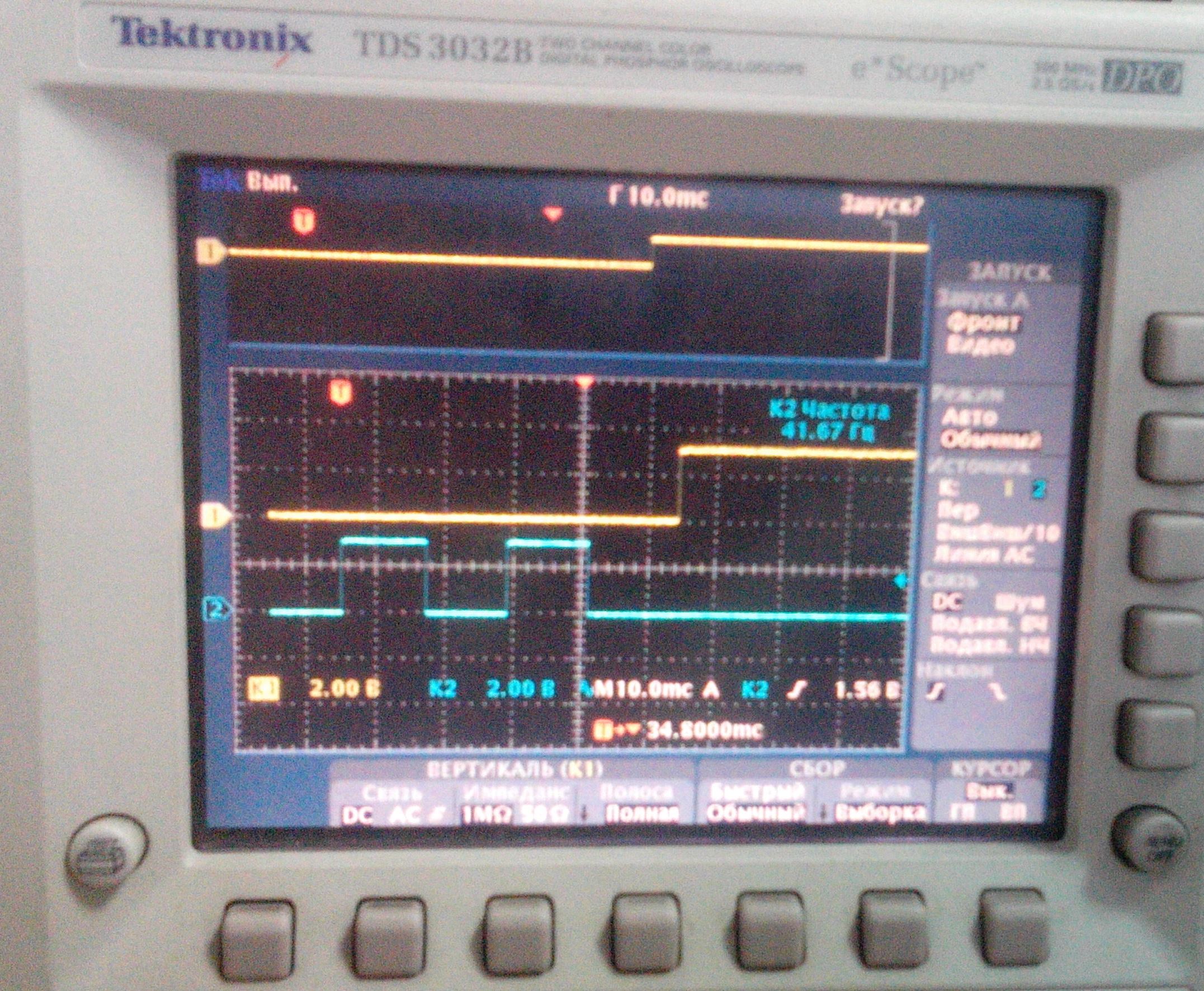

Hello!
I'm trying to program the MSP430F5418A rev. H processor using BSL.
MSP430F5418A Errata says, that rev. H doesn't have SYS10 bug. So I assume that normal bsl sequence (shown in slau319i.pdf page 6) will start BSL.
But it doesn't start. Moreover, when I transmit mass erase sequence (packet = 0x80 0x01 0x00 0x15 0x64 0xa3), MSP430 answers with byte 0x90, instead of 0x00 (ACK for flash BSL devices)! 0x90 is te ACK byte for ROM version of BSL. Here is the BSL_Scripter output:
BSL Scripting application 1.01
The local time is: 10:43 on 21.01.2015
Initializing, Mode: FLASH COM: \\.\COM4 DONE
Verbose mode on
Using inverted RST!
Invoking BSL: DONE
Processor family is set to MSP430F5XXX
Mass Erase: {90} FAIL
-------------ERROR-------------
Press any button to exit
It looks like some old-version bsl starts inside of MSP430. For interest I tried to start ROM version of BSL using BSL_Scripter program with "INIT_COMM ROM" command. Here is it's output:
The local time is: 10:40 on 21.01.2015
Initializing, Mode: ROM COM: \\.\COM4 DONE
Verbose mode on
Using inverted RST!
Invoking BSL: DONE
Mass Erase: [80] {90} {90} DONE
Sending Password: [80] {90} {90} DONE
BSL Version: [80] {90} {80} {00} {10} {10} {11} {32}
{60} {a0} {00} {00} {00} {00} {00} {00} {01} {60} {01} {00} {71} {f2} {6f} {ef}
01.60
Erasing segment at addr 1880 [80] {90} {a0} FAIL
Why the normal BSL doesn't start?
Maxim.

  • Hi Maxim,
    Where did you get that BSL Scripter? The latest version is 1.07 and is available here http://www.ti.com/lit/zip/slau319. Can you give it a try?
    Additionally,
    - have you tried reading the contents of BSL area using JTAG? Does it match the following file? If different, can you send it to us?

    - What happens if you load the attached BSL?
    -  have you tried using a logic analyzer or oscilloscope to check the activity on the bus? Does it match what you are getting from the scripter?
    - The response from MSP430 is not expected from the application, correct? Is the MCU blank?
    - Can you try loading a "LED blink" example to the device just to double-check if the BSL entry sequence is working (and to make sure the device doesn't respond to UART messages).
    The behavior of the device doesn't make sense to me, because I'm not aware of any port of the ROM BSL to the F543x. But you never know, right?
    Luis R
  • Hello Luis.
    Thanks for your reply.
    My BSL_Scripter is old, but it is working perfectly with all my MSP430 processors.
    I'm sure, that MSP430F5418A is blank, TEST, RST and BSL signals are OK, I've checked them using oscilloscope.
    As for BSL area, it seems, that BSL is missing in my MCUs (or maybe it's area is blocked for reading???):
    1000h to 17ffh

    BSL_Scripter ver 1.07 invoked BSL correctly!
    And you know what is the difference between 1.07 and my 1.01?
    Look at BSL invoke procedure below (ver 1.07):
    Upper signal is RST, lower - TEST.
    Don't you think it is different from sequence shown in SLAU319.pdf?:
     That is why my BSL_Scripter did not work - because it is using invocation sequence right as shown in slau319.
    Interesting, that BSL in old MSP430F1132 (I have MSP430F1132 and MSP430F5418A on the same board) can't be invoked by BSL_Scripter_v1.07 sequence, but correctly invokes by my BSL_Scripter_v1.01.
    Maybe TI should make some modifications in SLAU319?
    But in any case thank you for forwarding me in right direction.
