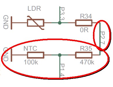

    The tests are based on the Experimenter Board MSP- EXP430FR5739.
    The NTC implementation on the Experimenter Board also uses a GPIO pin P2.7 to source the NTC device (see below detail from circuit diagram, User Guide slau343b.pdf).
    NTC has 100k resistance and R35 has 470k resistance. This gives at room temperature a sum of 570k Ohm.
    In my NTC circuit I also use an NTC with 100k (at 25°C) but a smaller resistor (in place of R35) of 100k. So the sum is about 200k Ohm at room temperature (now 22°C). Using a power source with 3.6 V you would have a current of 0.018 mA which can easily be supplied from a GPIO pin. So the problem should not come from this side.
    On the board we have a regulated voltage (from TPS77301DGK) of Vcc = 3.67 V (measured).

    2. Connect the output pin P2.5 to power the NTC circuit with 3.67 V. Now I can measure an NTC signal of 1.760 V as input for pin P1.3. From that value I would expect a conversion result of                1.76/3.67 * 1023             =  491 units.
    But reading the ADC10MEMO register I get values varying from 454 to 547 (during 50 measurements).
    This is a variation range of 93 units (+56 / -37  with an equivalent of +200mV / - 133 mV). Compared to the range from case 1., it is about 50 times worse.
    3. When I drive the NTC circuit directly from Vcc on the board I get the same bad results as in case 2.

    Solution:
    After hours of searching and reading, I found this posting from Jason Sachs:
         www.embeddedrelated.com/.../91.php&nbsp;
    Then I applied an R-C-Filter between the analog input pin and the signal from NTC.
    Incredible, that was it. The conversion result is now stable.

    Difference in series resistance = difference in ADC capacitor charging time!

  • The ADC connects to, and takes a snapshot (sample) of the to be measured voltage and stores this into a capacitor which, after disconnecting from the source/input, will be evaluated (converted) to a digital value.
    But as any capacitor (or maybe you understand better ‘battery’) the charge takes time, normally expressed in T=RxC.
    R is not a single resistor and C is not a single capacitor, in chapter 16.2.5.3 of the User’s Guide you see the equivalent of all of them.
    Some of the values are specific to the device which you can read in the Data Sheet other are depending on board/wiring capacitance and series resistor value (470K + 100K).
    From these parameters you need to calculate the minimum sample time needed for a good charge of the ADC capacitor to a representative voltage value. The time RxC gives you the time to a charge of ~63%, 5xRxC is near 100%, but for a more precise conversion result you need to take 8 (Tau) times (8xRxC).
    Maybe you now understand that when connecting your ADC input directly to your supply voltage the series resistance is very low and the capacitor charges fast, and just a short sampling time is needed. But in your NTC setup the series resistance is much larger and so the time needed to charge the capacitor much larger and a short sampling time is not sufficient to fully charge the capacitor.
    Buffering the NTC value with an extra capacitor connected to the ADC input pin will (partly) eliminate the NTC circuit resistance and a shorter sample time will work, but still needs to be calculated.

  • To increase precision, you may connect the port pin output to VeREF and use it for the ADC. This way, you eliminate the influence of the voltage drop on the port pin output.
    The main reason why the board uses a port pin to power the NTC is power consumption. When not actively measuring the temperature, you can pull the port pin low and the NTC won't draw any current.
    However, using the supply voltage of the NTC as reference makes the reading independent of the reference. But at the same time it means that you reduce resolution, since all the voltage across the top resistor is lost.
    Suggestion: make an Excel sheet where you have the NTC resistance at different temperatures, and the head resistance as variables and get the resolution (and expected ADC count). Then pick a head resistance so that you have your area of interest (the temperature range you want to cover) where your resolution is best.
    You may even extend the calculation by a parallel resistance to the NTC. If properly chose, you may get an almost linear reading in the area of interest.

    If current consumption is not a problem, I recommend using the TS431BCX or similar shunt regulator as external reference. It takes 1mA (you can tie it to an I/O pin for use on demand) but produces 2.495V +-0.5% which is way more precise than the internal 2.5V reference. And it i stable for even heavier loads - up to 100mA. But remember it's a shunt regulator. So it is a self-adjusting load that draws as much current from the source that the voltage breaks down to its reference voltage. You need to provide a proper head resistor between voltage source and regulator. I used this one a lot. It's cheap and small (SOT-5) and painless to use.
