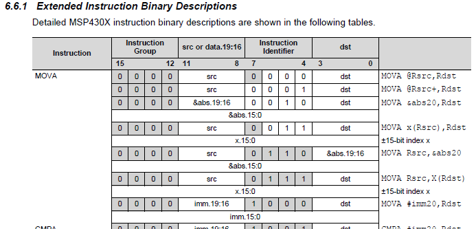

We are currently working on a main memory bootloader that is based on the MSPBoot project, this bootloader uses a proxy table that hat uses a BRA instrunction to a ISR.
The orgional bootloader uses a 16-bit BRA instruction to jump to a given ISR, this instruction is if we are correct represented by the hex value 0x4030.
Table proxy table entrys are then e.g.:
0x4030, (uint16_t) NameOfISRRoutine1
0x4030, (uint16_t) NameOfISRRoutine2
etc
Because of our code size (it extens above the first 64kb) we need to make 20-bit jumps, can someone tell us where w can find the hex value for a 20-bit address jump? Or what the hex value of a 20-bit jump (BRA instruction) is? Our target is the MSP430F5359, and we use code composer version 5.5.
Many thanks in advance.
