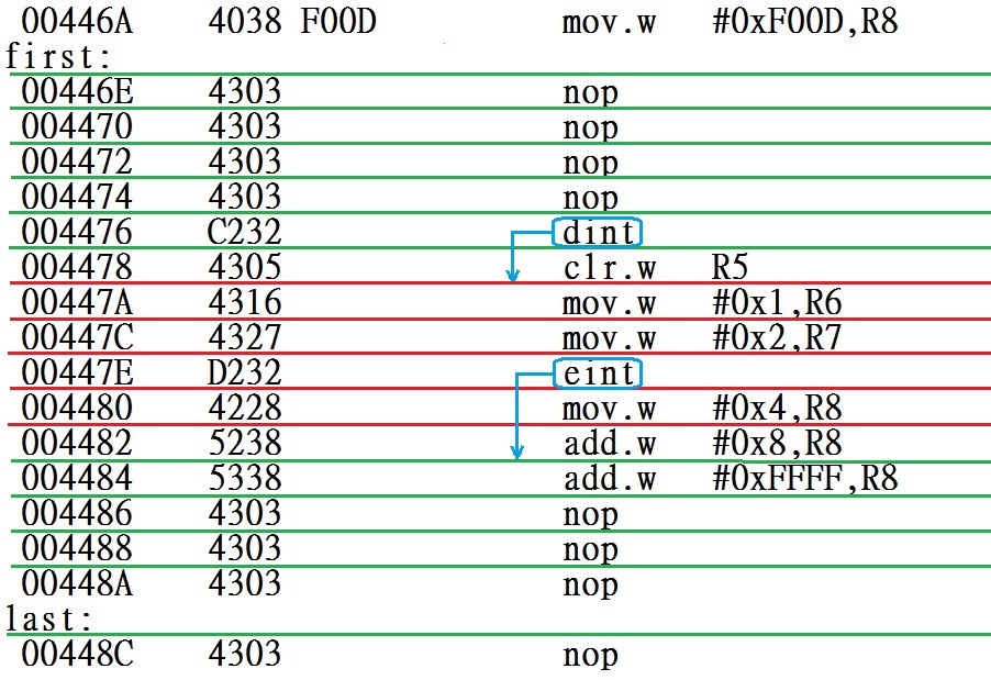

I tried to verify this and my preliminary finding contradicts to this Note. Furthermore, my finding contradicts to a similar Note for EINT.
I wonder if anyone else has ever tried to verify these Notes?
