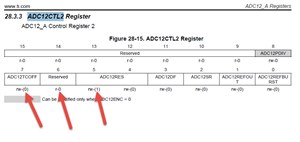

How are the default states of the control registers defined in the reference manual?
What's the difference between a 0 and (0) as seen in attached pic.
Legend
rw: Bit can be read and written.
rw-0,1: Bit can be read and written. It is reset or set by PUC.
rw-(0,1): Bit can be read and written. It is reset or set by POR.
A PUC (Power Up Clear) is ALWAYS generated by a POR (Power On Reset), but a POR is not always generated by a PUC. Certain things that cause a PUC will not necessarily alter RAM. A PUC is generated by the following events, as outlined in the Users Guide.
Ah.. yes, I see it now.
not sure why I couldn't find it with searches..
Thanks!!
This is also explained in the MSP430 Design Workshop. (It's on page 4-4 in the current revision of the workshop manual.)
