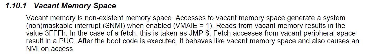

  • Hi abraxas2k,
    I assume you are using F5419A instead of F519A, correct? This address is invalid for F5419A as shown in the Memory map found in the datasheet http://www.ti.com/lit/ds/symlink/msp430f5419a.pdf.
    Section 1.10.1 of the User's Guide (http://www.ti.com/lit/pdf/slau208) mentions the following:
    So, you can try to enable this interrupt to capture when the device jumps to this location.
    Now, you probably captured this state but the device probably could have failed somewhere else. I strongly recommend you to make use of the EEM module to try to debug this issue.
    Check SLAA393 http://www.ti.com/lit/pdf/slaa393 if you use CCS, and SLAA263 http://www.ti.com/lit/pdf/slaa263
    Luis R
  • Hi Luis,
    thank you very much for leading me to this! Yes, I indeed use the F5419A.
    I will enable the VMAIE and implement a simple routine to catch that interrupt.
    Only one further question: Why didnt I get the PUC? I'm not sure I understand this passage correctly, but is the intention here that i get a PUC only when i try to enter a vacant peripheral space? And is a "vacant peripheral space" ANY space in the vacant memory space or maybe even a not activated peripheral?
