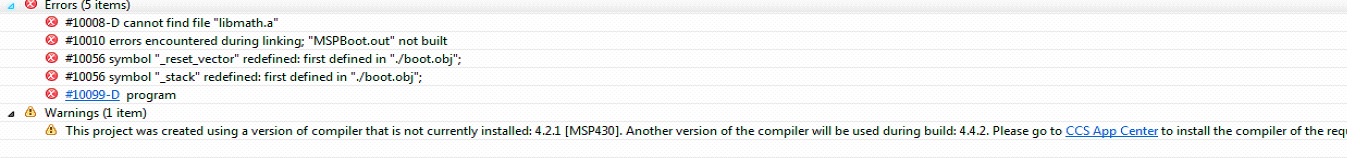

I downloaded MSPBoot 1_01_00_00 from link ‘’ and tried to build MSPBoot on CCS version 6.0 with TI V4.4.2 compiler, it is throwing following errors. These errors are after I corrected the path of the included header files. Please help me to resolve this problem.
Deep
  • Hi Deep,
    I just tried this on the same version of CCS (6.0.1.00040) and v4.4.2 compiler.
    See the warning at the bottom? You need to go to Project > Properties and under General, you need to set the drop down to set the compiler version to the latest version, TIv4.4.2. What's happening right now is the project setting is still set to the older compiler version, even though you have a newer one installed. When I did this, the warning and errors went away.
    One other tip - you mentioned having to fix paths of header files - I did not have this issue. I'm wondering if, when you imported the project, if maybe you accidentally had "Copy files into workspace" checked? When I imported the project, I followed the steps in www.ti.com/lit/pdf/slaa600 and I see that it has copy files into workspace unchecked in the project import dialog - doing this I did not have to change any paths.
    Katie

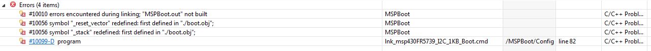

  • Hello Katie,
    I did both changed the compiler version and unchecked copy files into workspace but still getting errors. Please find attachment.
    Deep
  • Hi Deep,
    I reproduced your issue - sorry for your difficulties. Try going to Project > Properties > Build > MSP430 Linker > Advanced Options > Runtime Environment and for the dropdown for Initialization model, try setting this to be blank instead of "Link using RAM Autoinitialization model". Then clean and rebuild. For me this resolves the issue - we are still determining the best way to fix it in our MSPBoot code on the web, but hopefully this will get you up and running.
    What seems to be happening is that boot.c in our MSPBoot project, is overriding _reset_vector and _stack in the runtime support library boot.c. This is happening correctly in the older compiler version (I found that it works correctly in 4.3.6) but in the newer ones (4.4.0 and later) we are getting this error. Setting the initialization model blank in this way forces it not to use the boot.c in the runtime support library and to use our custom boot.c instead, and this is why the error disappeared. Thanks so much for reporting the problem so we can update this project so others don't run into the same issue.
    Katie
