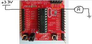

  • Programmed flash, removed all jumpers to emulation board, and with power supply 3.3V into VCC. Like that :
    When measuring no jumpers to LED also.
  • I like to measure on the high side as having 1K on ground can not be good as gnd should always be the least path of resistance.
    the Launchpad makes it easy to measure high-side, the Vcc jumper will be replaced with two leads going to Multi-Meter.
    All other jumpers need to be removed, is the pcb reversion using external pull-up resistor on P1.3? (I think some older version did?)
    Are all unused pin set with pull resistor enabled, in pull-down mode preferable.
    Even Port3, though not reaching outside on the 20pin version of G2553 it (may?) internally still be floating.
    As C  hides what is really done by using intrinsic, in Main code you write directly to SR
    in IRQ you need to modify the value it have on the stack, as when a IRQ exits it writes this value back to SR.
    That is all done in hardware  and you can not change hardware, but you can "trick" what value it thought it had when it entered in to the IRQ.
    __bic_SR_register_on_exit(LPM3_bits)
    And if you where not in LMP3 mode to start out with , nothing bad will happen as bic is like ANDN

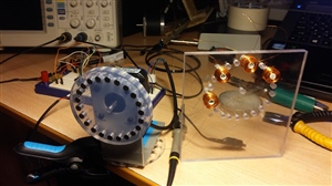

  • You see, there is rotating disk with magnets ( 8 magnets). If disk spining 1 rotation per second, i need send 8 data packets. So what i should use to catch magnet insteed of reed switch?

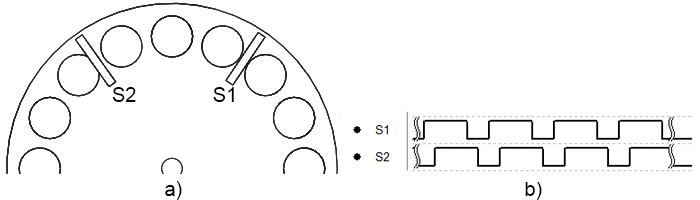

  • Ok then.. I have system like that :
    Now system works like generator (when coils are in front of magnets) . I want attach something between coils that will help to detect rotation direction of magnets. Air gap between magnets (neodynium n50) and coils is 1-2mm. You mensioned SM351LT, i read that is very sensitive device. Magnetic field created by the coil does not activate SM351LT ?  I need to get 2 sequences of pulses, whick i can decode and detect direction. This is my imagination using reed switches:
