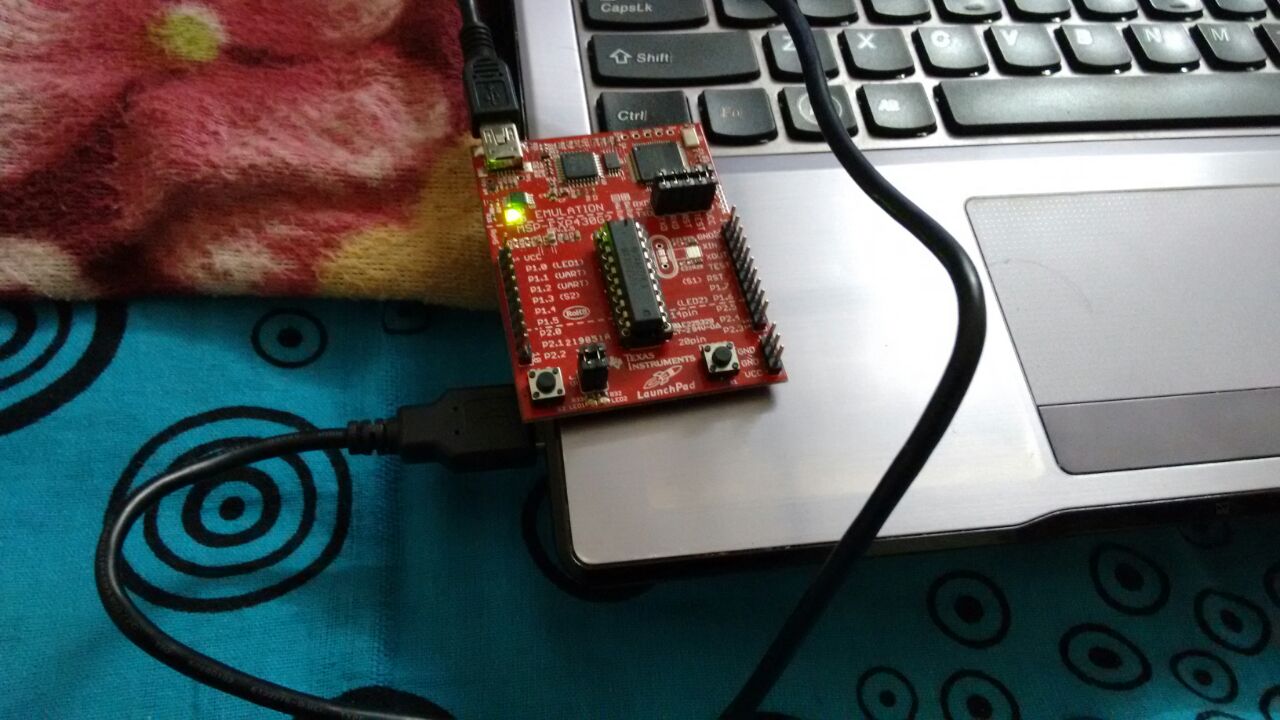

  • Thanks for the reply. But I don't see any message received. I have attached the image of launchpad interface to host pc. I believe this is the only connection, I, need to make it to work. Please let me know if I am doing it wrong or any other thing.
  • If you're using USCI via the USB connection the TX/RX jumpers on the launchpad need to be pointing left/right instead of up/down. If you look at the area between the word "EMULATION" and the jumper block (just above the target MCU) there's a diagram. You need to make the jumpers match the "HW UART" diagram.
