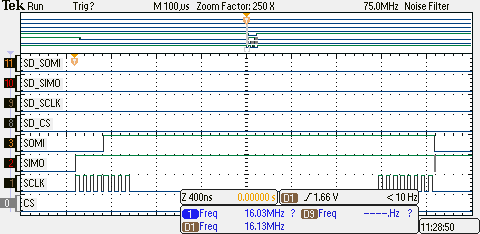

    But your hint with the realtime signals might solved another "srange thing" I witness: The serial communication with the AD7490 chip is done via USCI in SPI mode with 16MHz CLK and considerring the MSP430F5659 datasheet, i have some ~30ns until the next data can be processed. But i always read 820ns to almost 2µs on the scope and wonder what happens there, because an interrupt can not occur, since I am in an interreput routine and have no nested interreputs.
    Might that be a problem because of the debugging mode? I will try a free run on monday and measure again. Thanks for the hint! :)

  • Yes, applying 5V to an MSP input pin is probably deadly. The digital input pins (and analog pins if they have digital operations too) have clamp diodes which route over- or undervoltage to VCC/GND. But these diodes can only take up to 2mA rated current. A series resistor of >1k on the input pins will cause a voltage drop of >2V@2mA, limiting the current and protecting the pins against accidental 5V (or intended - at the expense of this additional current consumption, but for inputs, the series resistor may be as high as 47k or more). However, this clamping current will go to VCC, and if the total circuit current consumption is lower, it will raise VCC (up to Vin-0.3V) and is potentially dangerous too, e.g. if the MSP is in deep sleep mode at the event and doesn't draw more than a few µA from VCC.
    Debugging mode shouldn't influence the timing as long as there are no breakpoints (intended, implicit - by single stepping, or internal ones - e.g. for updating a register view or memory view update). It does, however, influence the low power modes, including DCO wakeup times. Even without hitting a breakpoint.
    When running SPI with 16MHz (something I have done too for SD card block transfer), one SPI clock cycle takes 62ns. But the USCI will handle a whole byte in one piece, so you have 500ns to put the next byte into TXBUF. However, when running the CPU on 16MHz too, this is only 8 CPU clock cycles, which doesn't let you do much more than just reading memory and putting it into TXBUF. Careful counting of clock cycles is required, since checking for TXIFG will take way too much time, writing too slow will waste bandwidth, writing too fast will result in skipped bates. The writing may have jitter, but the accumulated jitter must not result in less than 8 MCLK cycles per write.
    I created a set of inline functions that handle SPI out, in or simultaneous in/out in assembly, to meet the minimum 8MCLK requirement and do things as fast as possible otherwise. But the outcome somewhat depends on the type of data source/destination.
    The best method for maximum throughput would indeed be using DMA for the transfer. But the setup overhead makes this only reliable for larger transfers (above ~40-50 bytes).

  • Thank you for you detailed answers on both subjects! I really appreciate your efforts and help!
    As you mentioned I use the DMA now in edge-trigger mode and initialize the first byte send via SPI manually and so the next byte is directly send after the first one via DMA. I improved service time for about 26,2% of the whole 16ch ADC sampling routine.
    For the transceive function i used the fact, that previous DMA channels have a higher prioritx in servicing, so I triggered DMA0 for UCA1RXIFG and DMA1 for UCA1TXIFG. This works perfect! After the manual first byte send the DMA0 reads UCA1RXBUF and after servicing, DMA1 transmitts the second byte. After that I manually read UCARXBUF. It works perfect, without any interuption. Here two pictures of that:
    First without DMA (polling the UCA1TXIFG and UCA1RXIFG):
    and here the second image with DMA:
