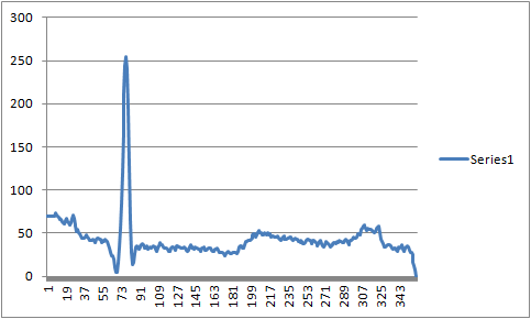

Hey everyone,
I'm working on a project that simulates a heart rate signal using the MSP430G2553, which is right now on the Launchpad. I'll try to explain everything I've done and what problems I'm having so I can get any help from you all.
I am using previous patients data that is available online from an MIT-BIH database. Because of the limited flash on the MSP430, I'm trying to just repeat a 1 second signal which has 360 data points. These values range from -0.535mV to 0.84mV. I don't actually need to output that small of data, since my output signal will later be going through an Analog Front End to with filters and opamps to make it the desired amplitude. I just need the shape of the signal to match the data. So, I am scaling the data. The scaling factor is using this equation S = (2^n - 1)/(Max - Min), where n = 8 and that is used to scale each data point using this equation newValue = S*(data - Min). Then I just round the data to get rid of the decimal and end up with data between 0 and 256. So that's the data. When I graph these points in Excel, it looks correct, as shown here.

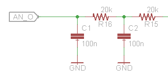

After I output the signal from P1.0, it goes through a filter
to see the analog output from the PWM signal. That is just an excerpt of the signal, but that's where I'm measuring it from right now. On an oscilloscope, this then gets distorted to look like this. The main issue I'm having is how large those two used to be small humps have become. I understand the chop in the signal since the repeating part doesn't match up nicely.
The program I am using was modified from the popular Simple DAC using PWM method found online. I'll paste the code.
I know this is a lot of information and a long post, but if anybody is able to just look through it, I would be very grateful. The main questions I have are
1) Does anybody have any insight into why those two bumps are so much larger than the excel graph or maybe why the peak isn't as large in comparison?
2) Also, since I'm using 256 PWM widths, my frequency is very fast. To make it more realistic, how would I go about increasing the frequency of the initial timer to output a much higher frequency signal without changing the shape of the signal.
Thank you all very much.

  • Jeffrey,
    First you set TAIE to enable timer overflow but you are not using it, this is waist of capacity.
    Maybe this setup can work (apparently not) I would do this on a different way.
    You have two timers, I would use both but it is possible with one depending on PWM frequency and step interval.
    One timer to generate the PWM-DAC and a second with a (much) lower frequency to step trough your array on the required interval time.
    The PWM timer gets the duty and can be outputted directly to the port pin.
    I don’t know if you have a resistor between the port pin and your filter input AN_0, if not you must add one or remove the first capacitor. The size of the resistor and the capacitor depends on the PWM frequency and the required output ripple.
    Leo.

    Thank you for your response. I am going to try to just use one of the timers. I may need the other timer later in the project since I am planning on using an external SD card to read in more than just one second of data to the MSP430 so I don't get the break between signals.
    For the filter portion, that is just a portion of the entire circuit that I am using. But yes, I am showing the signal from the oscilloscope as coming from after that 20kohm R15 resistor.

  • As you only have TA (and not TB) I think the problem could be that you are missing the window as the ISR can't finish in time if the values are below 50 and you are using DIV1 for the Clock. (so slow it down with DIV4 or 8)
    256 data points and using 8bit counter so you don't have to use compare and reset counter, saves a lot of cycles as it wrap around naturally.
    Oversampling will help slowing down the heart beat and improving smoothness. e.g use the same value 8 times before you step to next one.
  • Oops little mistake; You need to divide 6120 with the number of samples/hart rate, 6120/360=17.

    You also need to change your capacitor to ~22nF (and R=20K) to get best analogue output.
