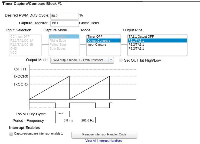

I am currently attempting to generate a square wave to through the specified speaker above using the msp430. We're currently able to generate a flat wave using the following code below. We're unsure whether we need another micro controller, or if there's a flaw in the code. Any modification to the posted code, or advice, will be much appreciated.
#include "msp430.h"                     ; #define controlled include file
        NAME    main                    ; module name
        PUBLIC  main                    ; make the main label vissible
                                        ; outside this module
        ORG     0FFFEh
        DC16    init                    ; set reset vector to 'init' label
        RSEG    CSTACK                  ; pre-declaration of segment
        RSEG    CODE                    ; place program in 'CODE' segment
init:   MOV     #SFE(CSTACK), SP        ; set up stack
main:   NOP                             ; main program
        MOV.W   #WDTPW+WDTHOLD,&WDTCTL  ; Stop watchdog timer
        BIS.B   #BIT1, &P2DIR            ;
        BIS.B   #BIT1, &P2SEL            ;
        MOV.W   #3822, &TA1CCR0          ;
        MOV.W   #1911, &TA1CCR1          ;
        BIS.W   #OUTMOD_7, &TA1CCTL1     ;
        BIS.W   #TASSEL_2 + MC_1, &TA1CTL;
        BIS.W   #LPM0 + GIE, SR          ;
        MOV.W   #1000, R7                ;
        JMP $                           ; jump to current location '$'
                                        ; (endless loop)
        END

     Hi Gabriel, after all mindstorming about how to ..
     You wrote are generating a "flat" wave, this means a square wave? So you see it on a scope?
     Just a doubt, weak but speaker must generate some sound, is loudspeaker good?
     From reset state register all carry zero default, but try change the two BIS on tacxxx register with a move to be sure register are forever set to a correct pattern.
     fast checked values of assumed 1MHz clock are ok so it must work or some different problem may be affecting setup.

     Yes Leo, 216Hz efficiency is low and SPL is probably less than audible threshold but SCLK is not specified too.. So it is time to have some feedback from Gabriel is silent from too much time.
     What I seen new GRACE version update all mode, so wroting register all other view got updated in consequence. Similar instrument are missing on other MCU series of TI. Another good tools is RF STUDIO for radio based CC series and CC chipset.
