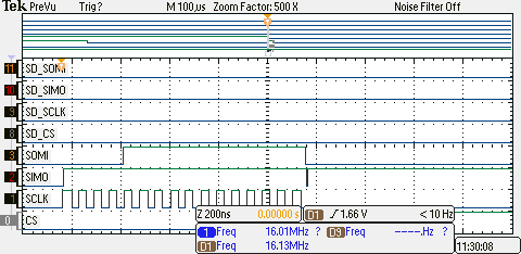

    I think my implementation is now very good. Here's the code:

    This works now really good with no deadtime between the packages. Here's a scope plot:
