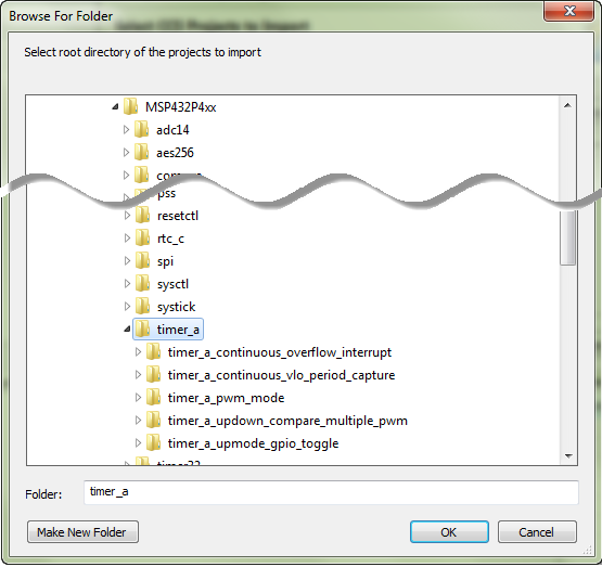

  • Sorry that I cannot try this out in Linux, but there might be an alternative way to load a project example. What I'm going to show here is generic to all the examples, but if it doesn't help, it might be useful for us to know which example(s) you're having problems with.
    In general, I like using the TI Resource Explorer, but you can always import examples and other projects 'manually'. You can do this by importing a CCS Project:
    Project -> Import CCS Projects...
    Then navigate to the directory that contains the project(s) you're interested in. For example, here I navigated to the "timer_a" projects in the MSP432P4xx folder inside the latest version of MSPware DriverLib. Since I took the default EXE installation location, here's where this is on my PC:
    C:\ti\msp\MSPWare_2_10_00_15\driverlib\examples\MSP432P4xx\timer_a

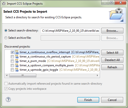

    Once you've select a directory that contains projects, you can select which one (or more) you want to import into your CCS workspace:
    Please note, if you've already tried to import a specific example, or already created your own project with the same name, Eclipse (i.e. CCS) workspaces won't let you have two projects with the same name.

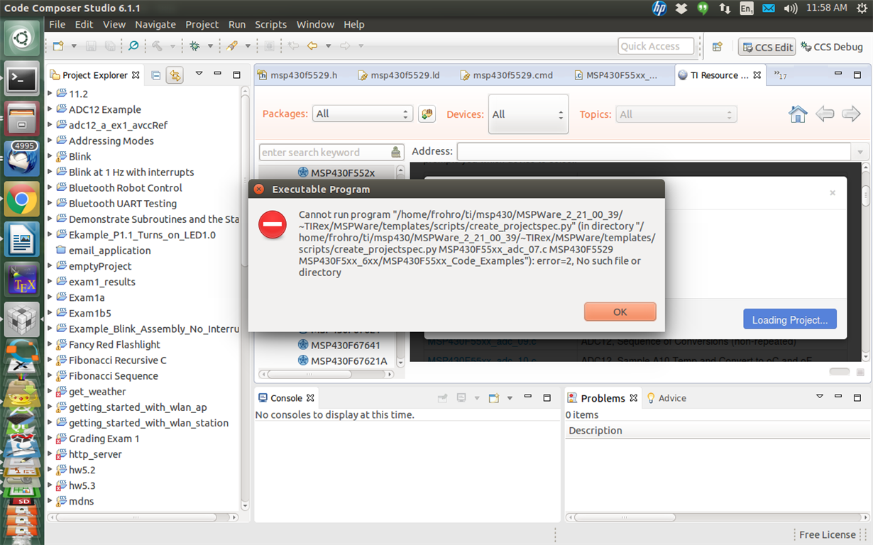

  • Unfortunately this seems to be a recurring issue for me.  I am teaching an Assembly Language class where we are using EXP-MSP430F5529LP launchpads and Code Composer Studio.  The C examples are useful for my students, but MSPWare is usually broken at the point where you try to view the C files or where you click the blue "Create" button that becomes "Loading Project."  The message is shown is the screen shot.  (You can't copy and paste the message, which is also annoying.)
    I poked around and found that at least one problem may be related to the fact that the C directory isn't in the argument, but it is there in the files installed in MSPWare, but I don't know.  The only way I have found to nicely work around this is to copy the whole installation from a working computer that wasn't updated with the latest MSPWare, and use that.  Can you make this work?  My students and I have had the problem on Windows and Linux.
    Rob
  • You definitely installed the program as root. Just use chown to change the own of  ccs. I changed the owner of the entire /opt/ti directory to the user and everything works perfect.
  • Thanks for the reply!  Unfortunately that didn't solve it for me (Ubuntu 15.10).  I did a sudo chown -R frohro ~/ti, but I still get this:
    It is annoying that you can't copy and paste the error into Google or this post.  It just won't allow me to copy it.
    I did make a work around for my class though.  I made a workspace with all the MSP430F5529 C examples, from which my students can import.  It isn't as nice as when CCS used to work, but it it is better that digging through the directories looking for the source, and pasting that into a new project.  The workspace is here if anyone else needs it:  http://people.wallawalla.edu/~rob.frohne/ClassHandouts/Assembly/example_workspace.zip
