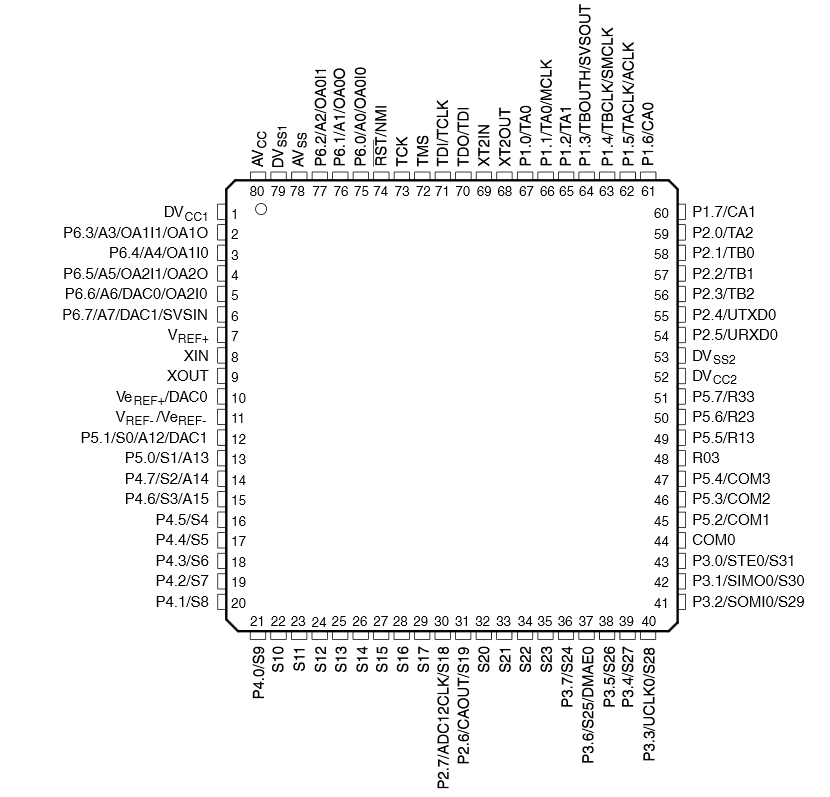

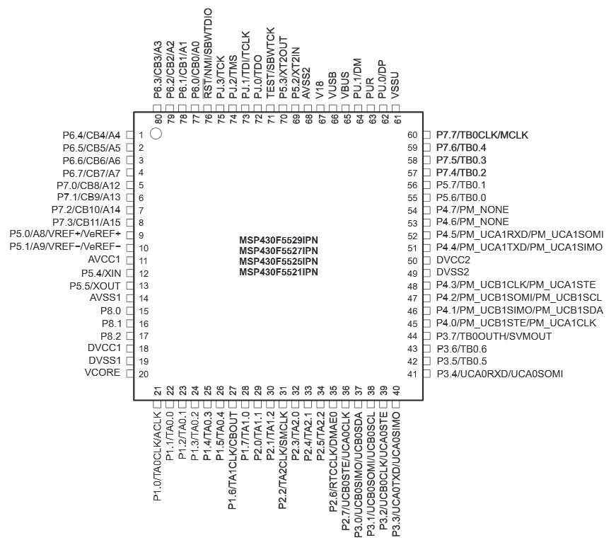

    Now compare the pinouts. The MSP430F5529:
    This has SPI SIMO at P3.0, SPI SOMI at P3.1 and SPI CLOCK at P3.2 (as defined in your code, of course).
    Now let's look at your new MSP430FG439:
    This has SPI SIMO at P3.1, SPI SOMI at P3.2 and SPI CLOCK at P3.3 - so how should this work if you do not adapt the connections according to your new processor?
    Just copy paste is not possible. As I said, the configuration has to be changed.
    Dennis

  • "#define SPI_SIMO BIT1 // 0x0001"
    That's not enough. The port itself has changed too (which isn't covered by the bit defines at all).
    Also, minimum divider for the baudrate is /2, while the USCI can do /1 if running as master. But that's correct in the code.
    The USART also offers the TXEPT flag, which can be used to determine whether sending is complete (must be set before you can de-assert CS). The USCI has the UCBUSY bit that serves mainly the same purpose but must be clear to indicate the end of the transfer.
