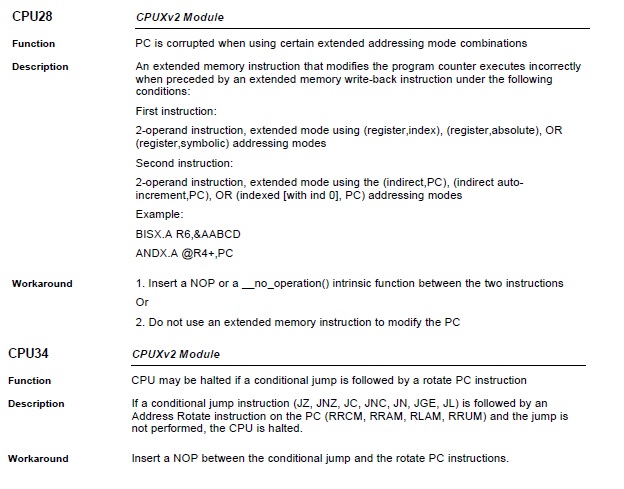

Do you know how to modify the PC(program coutner) in C program ?
MSP430F543x has errata CPU28 & CPU34.
I believe that we can program the C language to avoid this errata If I know the PC how to modify.

    I'm referring to the following documents.
    MSP430F5342 Device Erratasheet(5 & 7page)
    www.ti.com.cn/.../slaz278m.pdf

    I can not judge whether the compiler to avoid CPU bugs of CPU28 & CPU34.
    Mino.M
  • You can inspect the object code they generate. You may find that there are planty of NOP here and there including the ones that can work around CPU28 & CPU34.

    I understand that it is not possible to care at the time of programming.
    In other words,  this errata(CPU28&34) can not be avoided unless I check the ASM output by the compiler.

  • Errata list situations where the system does not behave as expected or described. Sometimes it even lists things that ARE described in the users guide, but are not expected/surprising.
    However, those anomalies do not need to be sane at all.
    I don't know why someone should do a rotate PC operation. what good would it do to multiply the program counter by two or divide it by two? I can't figure out any real-world situation where CPU34 would hit.
    IMHO, the only indexed operation generated by a compiler where the PC is the target (CPU28) would be the __even_in_range() intrinsic, which adds the interrupt vector (xxIV) register to the PC for a jump table. In case the compiler doesn't take care of this itself (and usually, such errata are known and supported by the compiler), you can add a NOP right before the switch statement.
