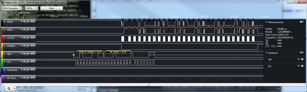

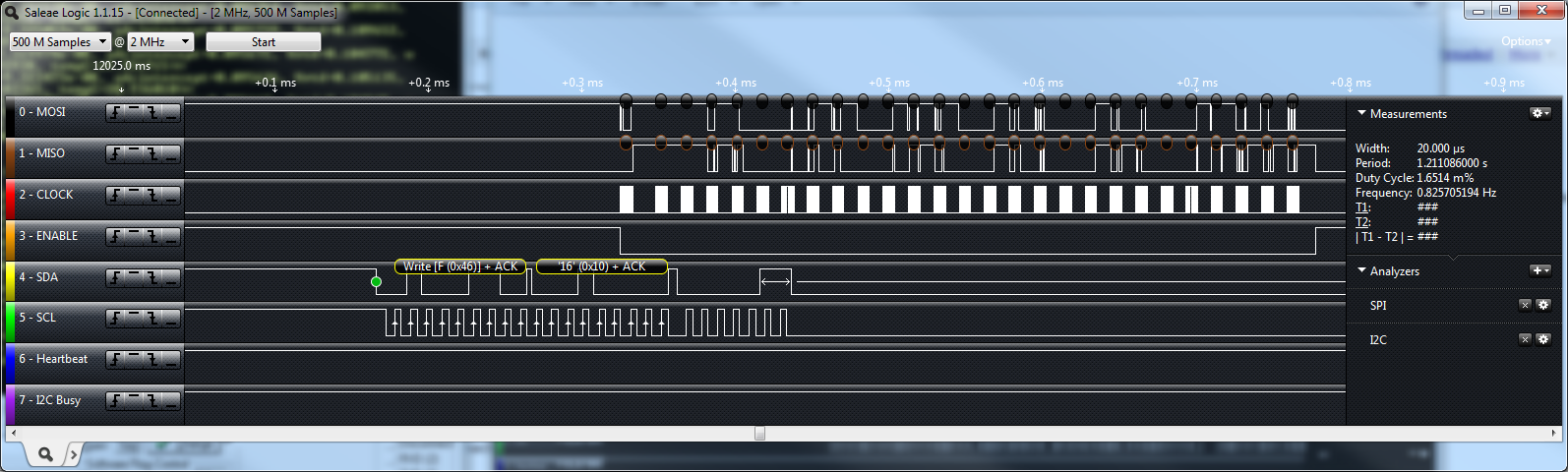

Here's an example where an SPI/I2C collision doesn't result in the I2C stalling:

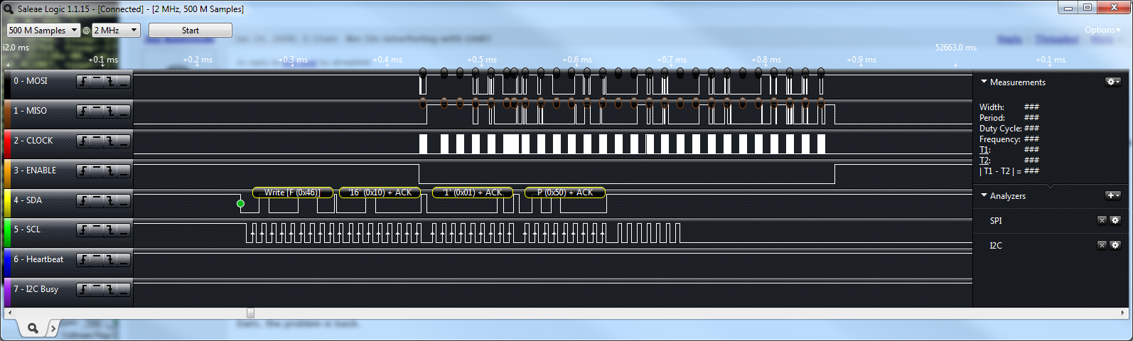

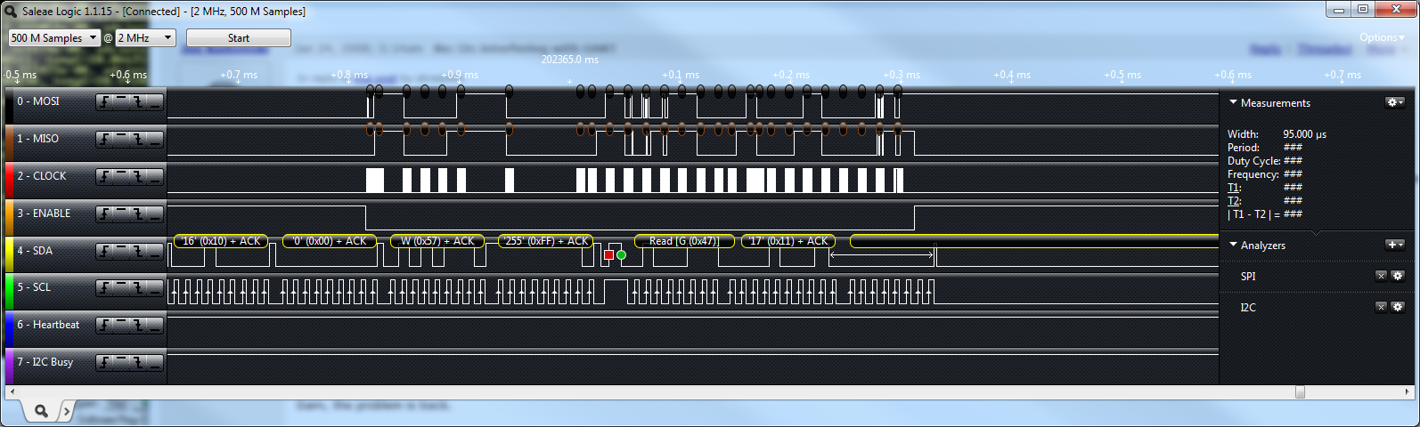

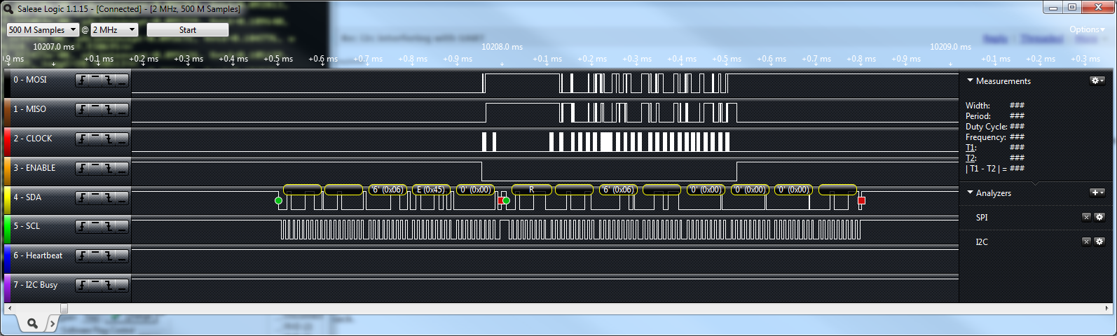

And here are some examples where the I2C stalls during a collision:

    My tests so far have run for a little longer before dying, and the failure mode has been more consistent (I2C stops transmitting the byte after an SPI transaction starts during the slave->master message), but I've also seen I2C die in the middle of an SPI transaction during the master->slave transmission once or twice.  In any case, I2C still stalls during some collisions with SPI even though SPI is not interrupt driven.
