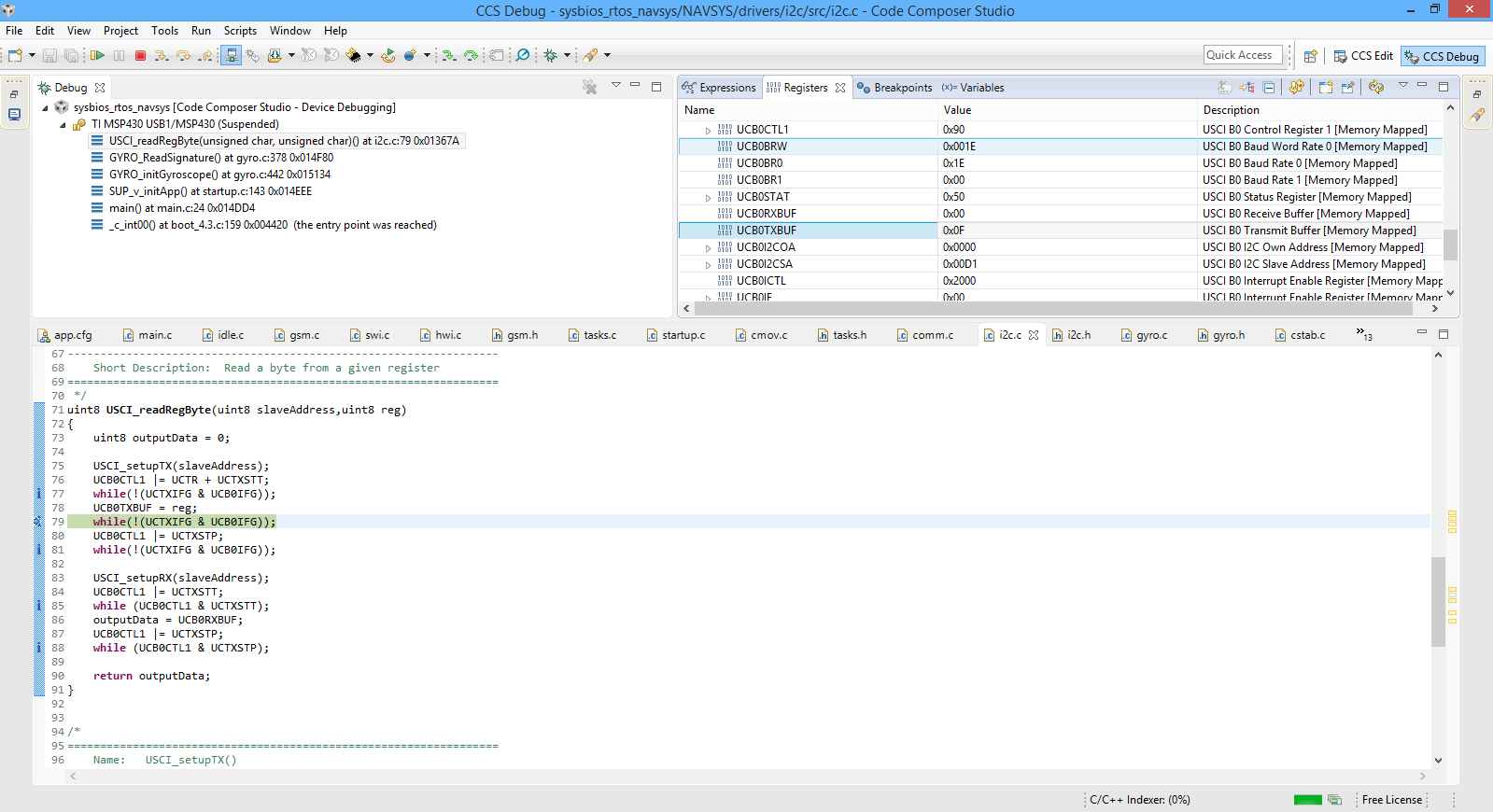

I'm going to read some data from a gyroscope connected to the MSP430F5529 microcontroller through the I2C connection.I also use the driverlib from the Ti version 2_10_00_09. The problem comes when I try to get a value from the sensor, it stays blocked at the following line.
   // Poll for transmit interrupt flag.
    while(!(HWREG8(baseAddress + OFS_UCBxIFG) & UCTXIFG))
Could someone explain me why  happens this ?

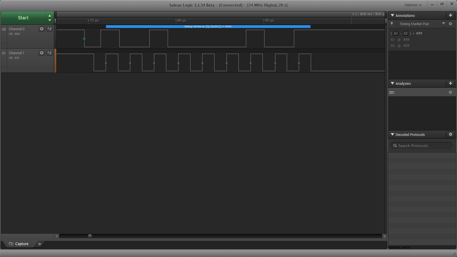

  • This is what I've got with a logic analyzer:
  • When I paused the program, it gets stuck at that while. Therefore the value from UCB0TXBUF is not sent.
  • Are you sure that you are receiving the slave acknowledge necessary to clear the UCTXIFG? Your logic analyzer screen shot is a bit confusing, can you confirm that the correct slave address is being sent? Otherwise you will not receive a slave acknowledge.
    Ryan
  • I am not sure the slave address is sent, this is the only thing I can see with the logic analyzer. I've also checked the CS pin ans is linked to 3V3.
  • The blue text says "Setup Write to [Q(0x51)] + NAK", if Q is the slave address then you're not sending the correct address. Once again, it's hard to tell from that screenshot but at any rate I doubt you are receiving the NACK needed to clear UCTXIFG.
  • I am at a loss what to say, but I think I found the issue. I've measured the voltage for the device and I've seen that the voltage is 3.88V. It means just a thing, the LDO is broken. I will try to replace it and I will post again.

  • "if Q is the slave address "
    Yes, the analyzer tells that slave 0x51 is addressed for write operation (start byte 0xa2 is sent) but the slave doesn't answer.
    The screenshot leaves no doubt.
    If 0x51 is the 7 bit address of the slave (so 0xa2 and 0xa3 are used as start byte to addressed it), then there is a hardware problem. Did you connect the common GND? (don't laugh - happened quite often in this forum)
    If the slave doesn't answer, the USCI is waiting for you to notice that UCNACKIFG is set and you set UCTXSTP to end the communication. UCTXIFG is cleared at the NACK.
    The broken LDO is of course a problem, but shouldn't break the communication - unless the MSP has been fried.
