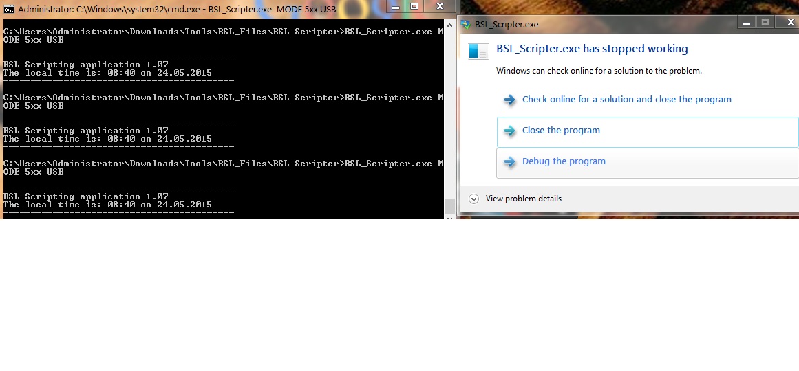

    After I typed as following command: "MODE 5xx USB" to initialize the selected communication channel for a BSL session. Then it stops working! Mind you give me a solution for this case ?
  • Change default "script.txt" file by yourself and then run it from prompt like...
    BSL_Scripter.exe script.txt

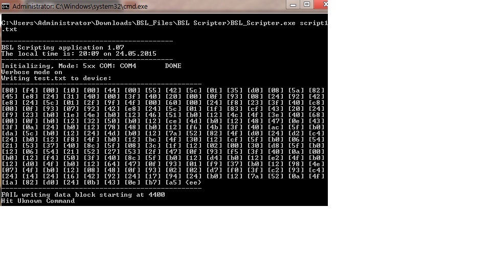

    After I have accomplished as you said, there is no "stopped working" case but this displayed an error. Do you think about this case ?
    My script includes as following:
         MODE 5xx COM4
         VERBOSE
         RX_DATA_BLOCK test.txt
  • As I noted in last post, start with default script.txt from slau319.
    slau319\BSL_Files\BSL Scripter\Demo Scripts\5529_Application_Download\script.txt

    I would like to use BSL Scripter. Then I modified like script_example but it still wait for a long time when writing test.txt file!

  • Before executing BSL Scripter you must force 5529 target device to USB BSL mode by RESET / BSL (PUR) buttons. Press both buttons together, release RESET button first, and after release BSL (PUR) button. I advise you to use user friendly TI GUI interface.
  • Hi zrno soli,
    As you mentioned about TI GUI Interface, May it issue my problem ("Fail writing data block at 4400") ? If needed, Mind you share materials for me ?
