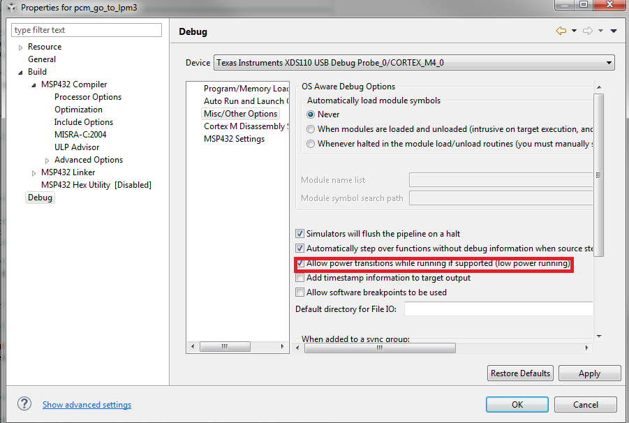

    Also note that in order to enable LPM3 transitions with the debugger connected, you have to specifically enable this setting in the debug menu for XDS110:
    ... without this mode enabled, when debugging through CCS and entering  LPM3, the debugger will actually only go to LPM0 (which may explain the behavior that you see with EnergyTrace). Enabling this option will make it so the device truly goes into LPM3.

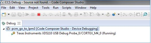

    With this option enabled, in the current CCS (6.1.0.00104), there is an issue that once you download the code you have to go through some additional steps to get the program running. Once you click debug, the code will download, however you will not be halted at main.
    In this case, you want to click the "Texas Instruments XDS110 USB Debug Probe_0/CORTEX_M4_0 (Running)" branch, pause the debugger (which will show your program counter sitting at the start of main), and then resume execution. After you do these steps, CCS will be running with true LPM3 transitions enabled. I am talking to the relevant people internally to get this process simplified in the future.
