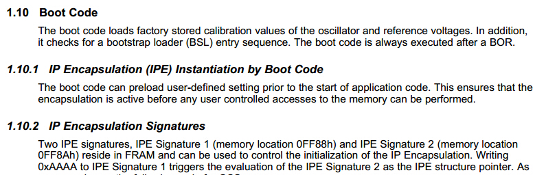

in the FRAM,IPE is used for  Intellectual Property,refer to FRAM's User Guid,when powered up,MCU will first excute boot code,boot code will prelaod user-defined setting in which we can write IPE Regisitor,after that,IPE code eara can be protected. TI has give examples how to realize it using CCS,if I use IAR,what can i do to realize it .

  • // This is the project dependent part
    // Modify where you want the start and end address for IPE segment
    #define IPE_START 0x04400 // This defines the Start of the IP protected area
    #define IPE_END 0x04800 // This defines the End of the IP protected area
    * Do not change this section - BEGIN
    // Hardcoded memory signature location
    #define IPE_SIG_VALID 0xFF88 // IPE signature valid flag
    #define IPE_STR_PTR_SRC 0xFF8A // Source for pointer (nibble address) to MPU IPE structure
    // Define the IPE signature location to 0xAAAA @ 0xFF88 to enable IPE
    #pragma RETAIN(ipe_signalValid)
    #pragma location=IPE_SIG_VALID
    const unsigned int ipe_signalValid = 0xAAAA;
    Locate your IPE structure and it should be placed on the top of the IPE memory. In this example, IPE structure is at 0x4400
    #pragma RETAIN(IPE_stringPointerSourceSource)
    #pragma location=IPE_STR_PTR_SRC
    const unsigned int IPE_stringPointerSourceSource = ((IPE_START)) >> 4;
    // IPE data structures definition, reusable for ALL projects
    #define IPE_SEGREG(a) (a >> 4)
    #define IPE_BIP(a,b,c) (a ^ b ^ c ^ 0xFFFF)
    #define IPE_FILLSTRUCT(a,b,c){a,IPE_SEGREG(b),IPE_SEGREG(c),IPE_BIP(a,IPE_SEGREG(b),IPE_SEGREG(c))}
    typedef struct IPE_Init_Structure {
    unsigned int MPUIPC0 ;
    unsigned int MPUIPB2 ;
    unsigned int MPUIPB1 ;
    unsigned int MPUCHECK ;
    } IPE_Init_Structure; // this struct should be placed inside IPB1/IPB2 boundaries
    // Ensures the compiler do not optimize the structure since it is not called by the application
    #pragma RETAIN(ipe_configStructure)
    // IPE is defined in an adopted linker control file
    #pragma DATA_SECTION(ipe_configStructure,".ipestruct");
    // IPE is the section for protected data;
    const IPE_Init_Structure ipe_configStructure = IPE_FILLSTRUCT(MPUIPLOCK + MPUIPENA,
    IPE_END,IPE_START);
    * Do not change this section - END
    // An example on how to place code inside the IPE region
    #pragma SET_CODE_SECTION(".ipe")
    extern void blinkLedFast(void);
    extern void blinkLedSlow(void);
    #pragma SET_CODE_SECTION()
    TI has released a examples to realize IPE feature using CCS,what i can do to realize IPE in IAR refer to this code ?

  • i know what you mean,after 0xAAAA has been write to 0xFF88,the boot code will jump to 0xFF8A to execute, 0xFF8A is the start address of IPE configure structure,but the question is how to locate IPE configure structure at 0xFF8A

    This is actually easier now than it would look from the documentation. The doc is showing how to do it by hand. But you can let CCS/IAR do almost all of the IPE setup (init the structure and everything) itself.
    Here's what I do in CCS to enable it:
    1. Every function that I want to place in the IPE section, I use #pragma CODE_SECTION(foo, ".ipe") to place it in the IPE section (may have to be a bit different pragma in IAR). The linker file has already defined an IPE section. Do the same thing for ISRs you want to encapsulate but put them in ".ipe:_isr"
    2. In the project > properties > General under the MSP430 IPE tab, select "Enable Intellectual Property Encapsulation", and select "Let compiler handle IPE memory partitioning based on user-code and data placement.
    If you do this, now what happens is the compiler will actually do all of the IPE register initialization for you! You don't have to set up the structure or anything. What happens is that the compiler will use a boot_special.c in the run-time support library instead of the normal boot c-startup code, and this includes setting up the structure and IPE registers for you. It determines the IPE register settings by knowing what address space that ipe section in the linker file is taking up when it builds. This makes everything quite simple.
    Please note that once you enable IPE, to be able to reprogram the part and be able to reprogram things in that area, you will have to tell CCS to do a special erase to erase the IPE area - you can do this under Project > Properties > Debug > MSP430 Properties and setting under "Connection options" to "On connect, erase main, information, and IP protected area". This will have it wipe the whole part so that you can actually program it again including that area.
    I believe that IAR has an equivalent of all of this - the pragma will be different (use "location" probably), and the linker file segment names are probably different, but that should be explained in the IAR user's guide. It also has this similar tool to just select IPE to be enabled in it when you use this to put your code in the right section as well.
    As a note, I think we're working to make some examples and doc of how to use the IPE to make this clearer and easier for people.
    Katie

  • old_cow_yellow said:
    ... In order to do that, you need to write a certain data pattern at certain locations (as described in the User’s Guide). The first time a BOR happens, the boot code will pick up those data and make your wish become true.
    I want to retract that. I now strongly suspect that Sections 1.10.1, 1.10.2, and 1.10.3 in that User's Guide are not applicable, obsolete, or erroneous.
    I suspect that the MPUIPLOCK bit in the MPUIPC0 register can be set to 1 by user code but can only be cleared to 0 by a special erase that also erases the contends of all the FRAM. (This also contradicts to the User's Guide which says it will be cleared to 0 by BOR).
    --OCY
  • Hi OCY,
    To my knowledge these sections are still applicable, but letting the tool do all the setup is just much easier than implementing it by hand this way. Basically it is doing the same thing as described in those user's guide sections, but it's doing it for you behind-the-scenes instead of you having to set up a structure yourself by hand. So I think having the information in the user's guide is useful, but should be presented more as a "here's how it works" and less as being the way you have to implement it - it should recommend you to use the tool.
    If you examine the linker cmd file in the latest versions of CCS, you can see at the bottom of the file a section starting with #ifdef _IPE_ENABLE. If you have enabled IPE in your project settings, this is defined. Then the following statements evaluate your settings options that you may have set in the tool, determine/calculate the borders of the IPE area based on code you placed in the IPE sections, and then figures out the address for where to put the IPE structure and calculates the struct checksum. So then the linker can place this structure in FRAM with all the information when you build.
    If you view the .map file generated when you build with this IPE enabled in the project properties, you can see where it has placed the ipestruct, and that it is 8 bytes long (just as described in section 1.10.3). If you then look at this address in the TI-txt binary file generated by building the project, you should be able to see what values it has but in the ipestruct.
    In addition, you can see that the ipesignature has been defined as well, and also view it in the TI-txt file starting at 0xFF88. Signature 2 at 0xFF8A contains the address of the ipestruct right shifted by 4 bits. So it is pretty interesting to look at the TI-txt file and see how simply enabling the IPE it does all of this initialization at these addresses for the struct and IPE signatures for you. So basically it's all doing exactly what is described in those user's guide sections, but you don't have to implement that code yourself.
    I do think that the user's guide does need to be updated to point out that you don't have to do all of this by hand anymore and can use the tool instead, and to make clear that these sections are just explaining how it could be done by hand and/or what happens behind-the-scenes. I have filed this as an enhancement on the docs.
