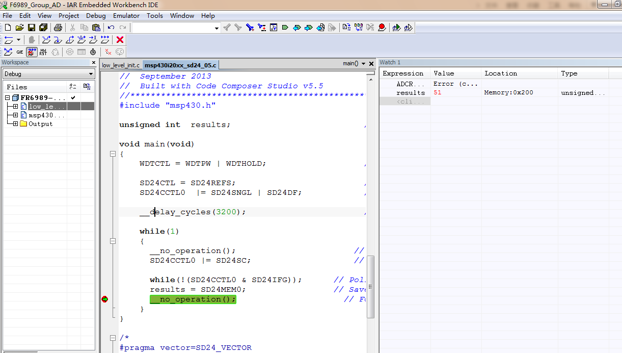

i used circuit above to test SD24 precision,but when tie A0.0+ to A0.0- ,there is a drift about 24/65536*1.16 = 0.4mv in my result, why this happens?

  • and there is a anther phenomenon,when there is a resistance between A0+ and A0- with A0- jumped to ground, the drift will become more obvious,for example ,if the resistance is 1kohm,the drift will be 51 with no change.
  • so the there is no difference bettween our circuit, can you give me some explans about why that happens?

  • i used your program above but the drift ( 24/65536*1.16 = 0.4mv)still exist, and will become serious when jumped a resistance between A0+ and A0-. when there is an OPA as input buffer before A0+(A0- jumped to ground ),this offest will lighten a little .

    After reading through documentation further, I believe this can be contributed to the offset error of the converter, which is specified by the datasheet in section 6.6.7.
    The calibration that we run in low_level_init trims the reference delay (for the reference voltage buffer start up) and trims the bias current of the SD24. Even tweaking these parameters did not give me the offset error that you are seeing, which leads me to believe that it is an offset error intrinsic to that individual unit.
    That being said, taking this information and cross referencing with the DS (especially Table 6-22), shows that this is not outside of the specified operation of the converter.
