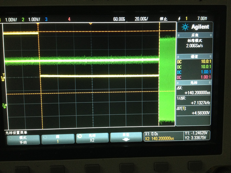

The yellow line is P1.3 , the green line is PJ.0 -----SMCLK
the result is that  DCO  nearly costs 140us  to start up,  Am I get sth wrong or I miss sth ?   Need your help , Thanks in advance.
    I think the issue is your are not configuring the PMM for fast wakeup. The 140us you are seeing falls in line with the wake-up time from LPM2/3/4 datasheet spec for slow wakeup of 150us typical.
    I strongly encourage you to use the driverlib code for configuring the PMM. There are code examples for driverlib pmm code in the mspware section of the resource explorer in CCS.
    Mike

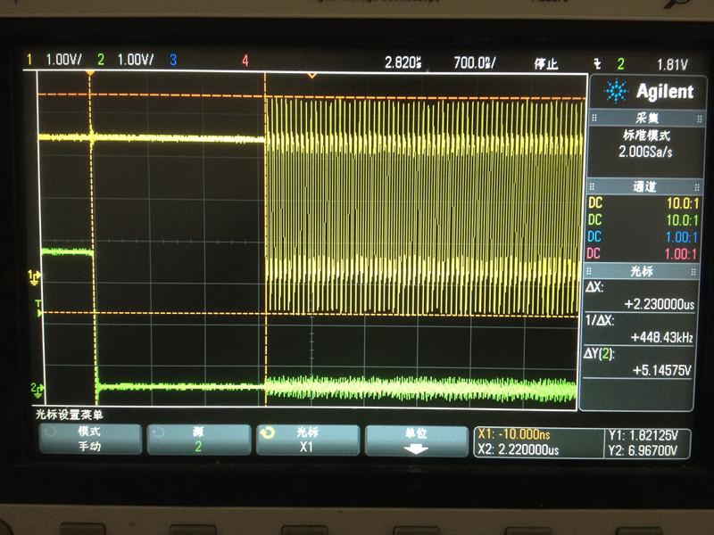

  • Hello Mike,
    Thanks for your answer. I have tried as you told me. It works when I enable the full-performance mode. However, another issue comes up .
    And still need your help.
    Now DCO can start up in less than 3us after the falling edage of STATR bit . but the frequence of DCO decrease to 8MHz if the system enter into LPM3.
    I set DCO runs @~16.7MHz .

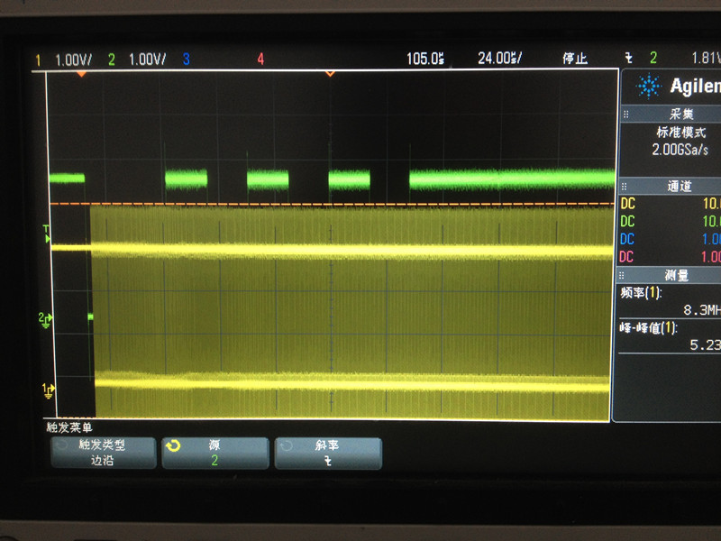

    The Green Line is P1.2(UCA0RXD)   Yellow Line ---PJ.0 (SMCLK)
    Which pulzzed me is that if I comment LPM3 , and use  while loop insead of LPM3 , the frequevce is become normal-----> ~16.7MHz.
    I checked the registers  of  UCS  before and after enter into LPM3 , they 're the same except UCSCTL0( I know its reasonable because of FLL cause.)
  • Dozens of experiments have made , All the clues directs to the DCO frequency issue.
    Before enter into LPM3 , DCO runs @~16.7Mhz. if a RX interrupt happens, wake the DCO from LPM3,
    the frequency decrease to nearly half of 16.7MHz(~8.3Mhz). Because the UART divder value is caculated based @16.7Mhz,
    A 8.3MHz CLK ,of course , will cause a fault baudrate ,then a corrputed byte in RX buffer.
    FLL is enable default after power on ,but will disable in ISR. However, MOD and DCO bits in UCSCTL0
    keep the same when a interrupt happens before and after , the only difference is DCO will not follow the
    reference CLk(32768Hz), am I right?
    Which confuse me most is how does a 8.3MHz frequency come up? It's unreasonable.
    I set a 4.1MHz DCO intetionally then enter into LPM3. The falling edge of START bit wakes DCO up,
    however, the frequency becomes nearly ~2.7Mhz.
    So it maks a rationaly doubt: DCO will decrease to (nearly)one half when it 's wake up from LPM3 .

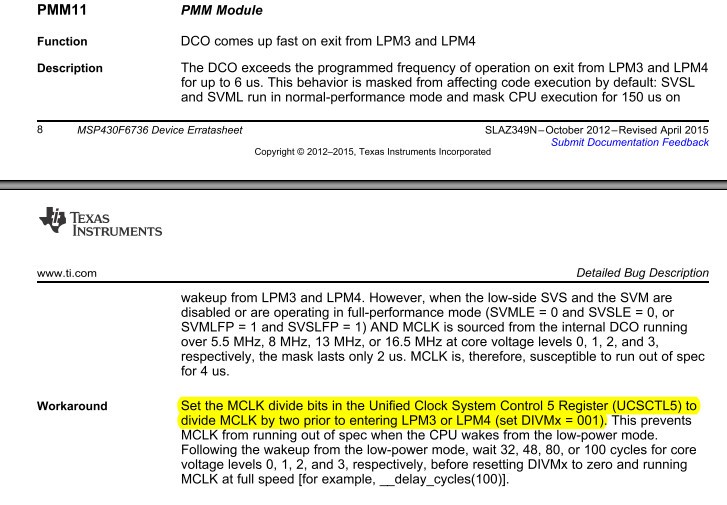

    Looking through the erratasheet of F6736 , PMM11 says DCO comes up fast on exit from LPM3 and LPM4,
    TI suggests to set the MCLK divders bits in UCSCTL5 to divder the CLK by two. This is a software way
    and applation code must involve in. Maybe...maybe TI has fix this up with a hardware way, Unpredictability,
    brings a side effect in my application...:) my guess.
    Need TI's help and confirmation.
    Thanks again.
  • Unfortunately (for the sake of finding root cause), thats not how the PMM11 erratum works, and we (TI) have not "fixed" it in the way you mentioned.
    Can you take a look at your UCS register settings before and after entering low power mode to see if anything is getting changed?
    Also, I see you are using V_CORE level 3. Are you changing one level at a time (as required), or are you going straight from level 0 to level 3? If you are using the latest version of MSP430Ware/driverlib for the VCORE changing functions (which I STRONGLY recommend), it will step the levels up for you one at a time.
    Mike

    I have done the experiments you mentioned. And the cause is confirmed .
    It's all about FLL.
    if enable FLL, the DCO frequency  can be caculated with this formula:
    D*(N+1)*32768 , (D--->FLLD)
    However if we disable FLL by setting SCG0, the frequency of the DCO  nearly halved.
    Uart Rx interrupt  happened when the whole byte is already formed and shift into RX buffer.  so, if  don't enter into LPM3, the SMCLK still works ,
    a correct byte can be "demodulated" by hardware UART.  If Enter into LPM3,and before START bit coming, SMCLK is shut down.
    when START bit  wakes DCO ,  hardware automatic disable FLL , and with a "halved" SMCLK , UART " demodulates"  a corrupted byte.
  • It looks like I find the cause, but how to solve the problem and meet my application is still a question. I can't use ACLK as UART's CLK, because it can not meet the baundrate requirement. LPMx (x<3) is also not a option , for its power consumption sake.
  • If hardware FLL does not work across LPM then you can try to tune DCO freq using software. At the moment you put CPU into LPM - you need running DCO at correct frequency /w FLL disabled.
    Would be nice to see TI comments here anyway.
