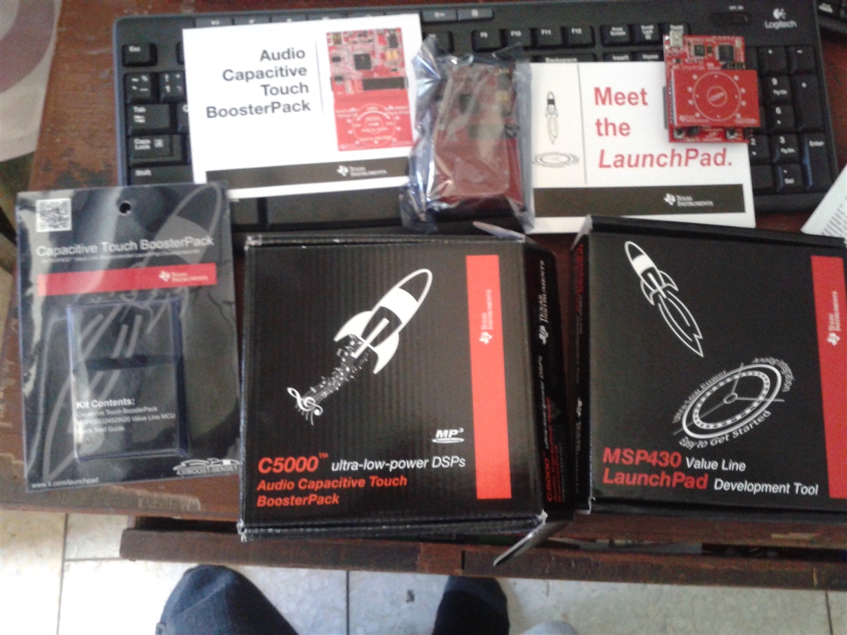

I bought  C500 Audio Capacitive touch 430Boost-C55audio1 and LaunchPad Development tool MSP-EXP430G2 and Capacitive Touch BoosterPack 430BOOST-SENSE1.

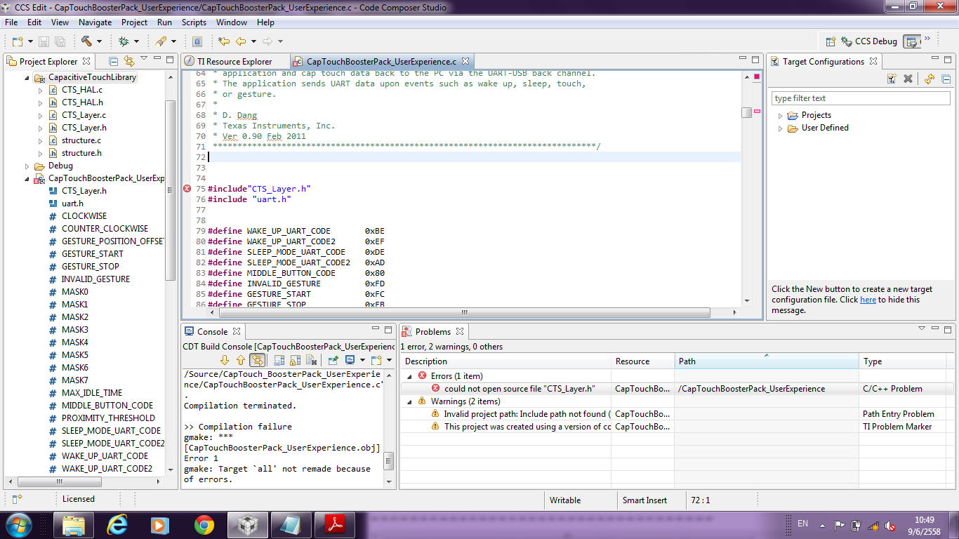

I add project CapTouchBoosterPack_UserExperience to CCSv5.
           I have problem when I "build all".Error could not open source file "CTS_Layer.h".
    I don't know why?Please, help me.

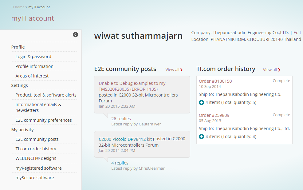

 And why my Order history don't show last order.I order 5/26/2015 order number 629803 .I recived ready.

    When you imported the project to CCS did you copy the project or link it?  There is a little checkbox for copying the project contents to your workspace.  Try removing the project from your project list and reimporting the project, this time unchecking this checkbox and linking to the project's current location.
