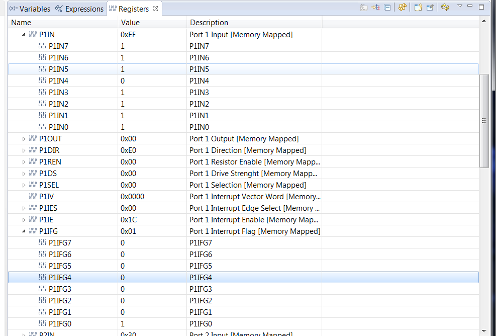

We're seeing an interrupt flag set on a bit that hasn't experienced a transition.  For PORT1, we have interrupts enabled for pins 2, 3, and 4.  Currently it's hard-coded to transition on a LOW to HIGH for all 3 pins (see following screenshots) - all 3 set as input - and as far as the hardware registers are concerned, we're set to wait for a transition on any of those 3 bits.
However, that we're seeing is an interrupt on one of those three pins without a data transition on P1IN. I've set breakpoints in
"__interrupt Void ti_sysbios_family_msp430_Hwi47(Void)" to try to determine what's happening, but to no avail.. by the time we're in there, all I see is the same data as before the ISR triggered.  Very puzzling.
Here is a screenshot of the PORT1 BEFORE the interrupt generated:

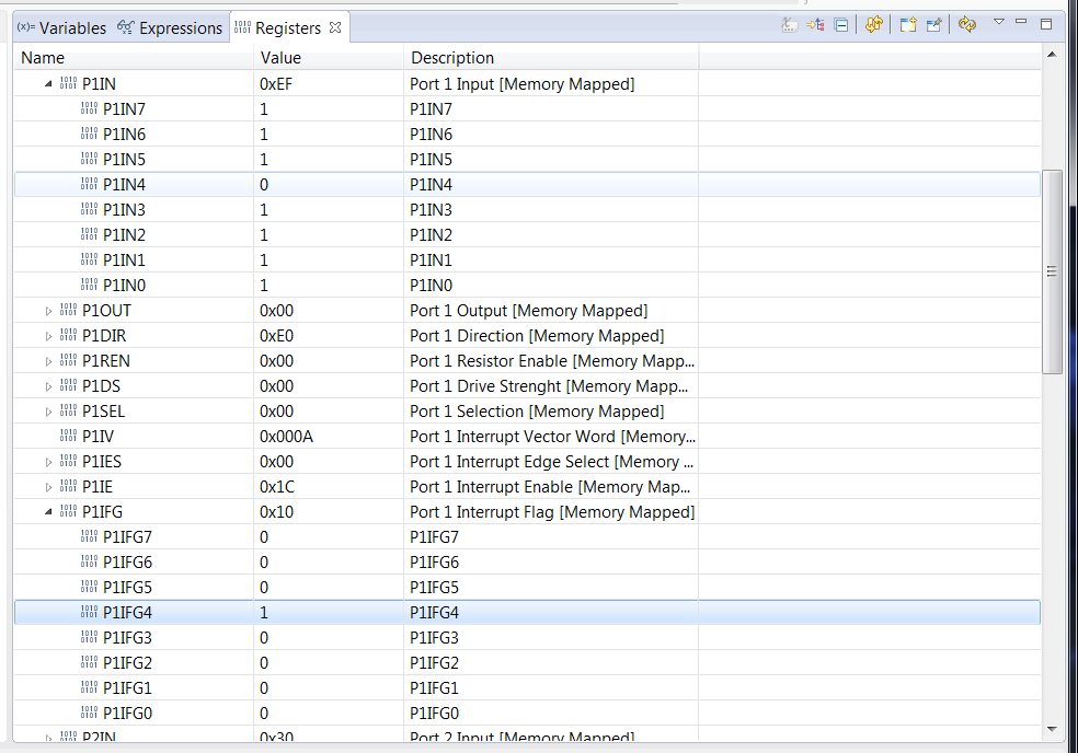

..and here is a screen-shot after the interrupt has triggered:
..and you can see that, while P1IN hasn't changed, I see P1IFG.4 set (and of course an interrupt triggered).
Can you provide some guidance as to how we might trace down where this might be coming from? We've put a scope on those input lines and the scope isn't seeing a data transition, either.

  • Are these pins pulled up or down? Did your code changed P1IES settings?
  • Some part of your software has changed the P1IFG0, in your first screenshot it’s set in the next cleared. Did the same part of software more modifications to this port?
    Is your oscilloscope fast enough to detect very short pulses or do you use a logic analyzer?
  • We clear all the P1IE flags on the start of the function, during port initialization. Bits 0 and 1 are unused, and as you an see from P1IE bit 0 and 1 interrupts are disabled. We also don't fiddle with P1IES in this version at all. They're inputs and are pulled up externally into a buffer chip, and that chip fed straight in to the MCU with (as you can see from Screenshot 1, P1REN) pullups disabled.
    Does this mean your Port1 initializing is between screenshot 1 and 2? If not, how else has cleared the flag?
