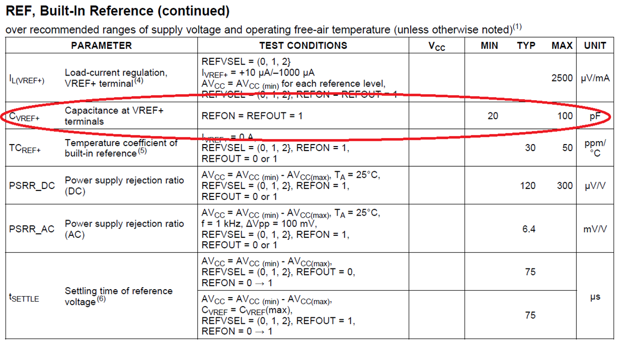

  • Have a look into the datasheet of the MSP430F5419A - there are two tables, one is for using the internal reference and route them to VREF+ for applying it to something outside the micro:
    As you can see the pin doesn't like a capacitance at all. So a capacitive load would be a bad idea, too. The reference could get unstable / start oscillating.

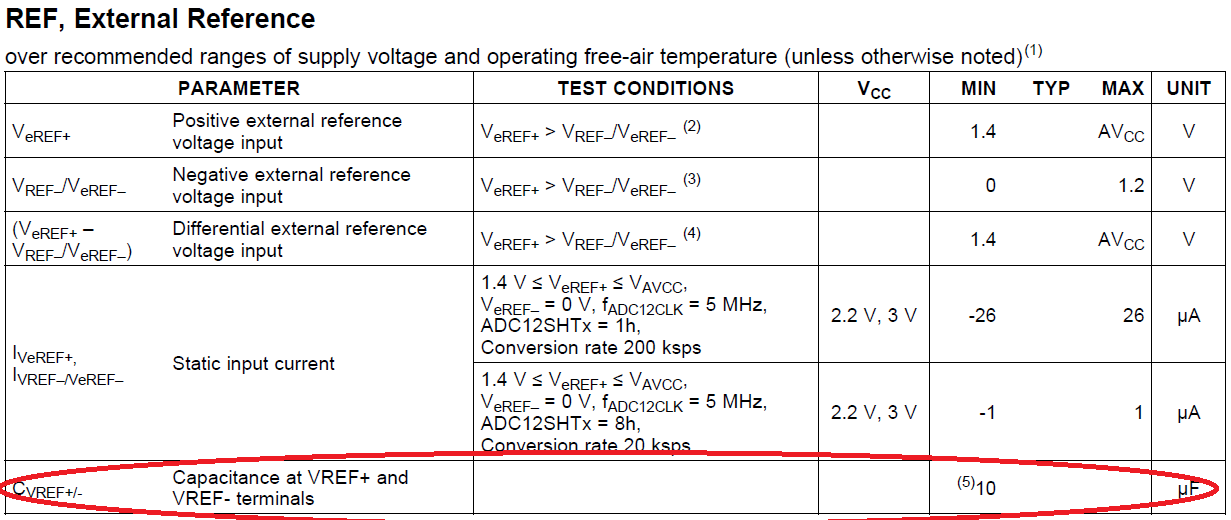

    But if you feed in an external reference:
    Then it is recommended to add a capacitance of 10µF to the pin to buffer the voltage.
    And yes, you're right - the older processors like the MSP430F149 required an external (5µF min) 10µF + 100nF when using the internal reference.
