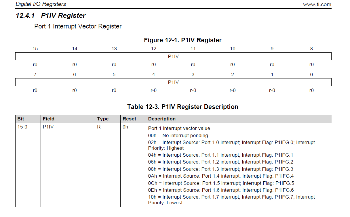

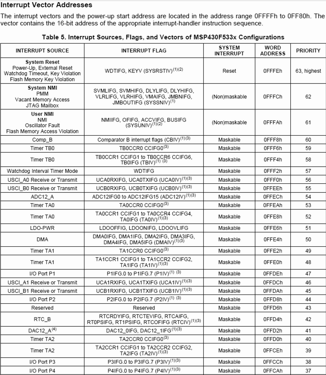

I have quite confusion after going through the interrupt priority handling articles. My confusion is " as per the MSP architecture if one inteerupt occurs it won't process any other interrupt untill the complention of the particular ISR, say for an example if two same priority interrupts are occurs simultaneously meaans how the ISR will be executed? Is there any chance to miss any of the interrupt because both of them same priority? Is anyone faced such a scenario? Please give me some inputs to handle this kind of scenario.
