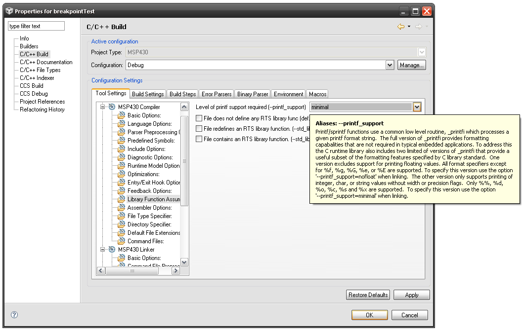

I'm trying to print out on the UART of an MSP430F2418 debug messages of my code. I am formatting those messages using vsnprintf, but whenever I'm trying to print a message which contains some formatting, e.g: %f %d or %lX, my program silently fails.

Compiler options:
--silicon_version=mspx --large_memory_model --printf_support=full
Linker options:
--use_hw_mpy=F5 --stack_size=1024 --heap_size=1024 --rom_model

  • Sonia,
    what is meant by the program "silently fails"? Crash? No output? Or..?
    Also, can you output at least simple strings or formatted integer values? (%u, %i, etc.)?
    As for %d, %g, etc., you may have good reasons for this but I would probably recommend avoiding trying to print such values on an MSP430 as they are quite taxing in terms of CPU time and memory consumption since you won't be able to use the smaller, more optimized printf() implementation of the runtime library. You could always generate the float-value strings on your host side if that's something under your control.
