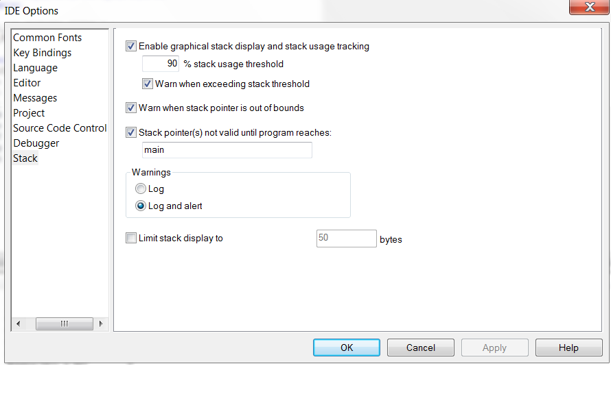

Not to mention that I have the following warning:
The stack pointer for stack 'Stack' (currently Memory:0x0) is outside the stack range (Memory:0x20B0 to Memory:0x2100)

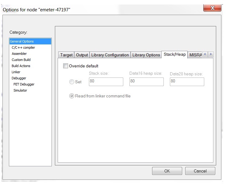

My info-mem is as follows.
// XLINK configuration file for MSP430F47197
// Copyright 1996-2010 IAR Systems AB
// $Revision: $
// Description
// Usage:
//   xlink [file file ...] -f lnk430f47197.xcl
// Device summary
// Core:                           MSP430X
// Interrupt vectors:              32
// Peripheral units:                   0-001FF
// Information memory (FLASH):     01000-010FF
// Read/write memory (RAM):        01100-020FF
// Read-only memory (FLASH):       02100-0FFFF
//                                 10000-1FFFF
// Segments
// Data read/write segments (RAM)
// The following segments are available for both
// the DATA16 and DATA20 segment groups.
// segment         Usage
// DATA<nn>_Z      Data initialized to zero
// DATA<nn>_I      Data initialized by copying from DATA<nn>_ID
// DATA<nn>_N      Data defined using __no_init
// DATA<nn>_HEAP   The heap used by 'malloc' and 'free'
// segment         Usage
// CSTACK          Runtime stack
// TLS16_I         Thread-local storage for main thread
//                 (require custom runtime library)
// Program and data read-only segments (FLASH)
// segment         Usage
// DATA<nn>_C      Constant data, including string literals
// DATA<nn>_ID     initializers for DATA<nn>_I
// segment         Usage
// INFO            Information memory
// INFOA           Information memory, bank A
// INFOB           Information memory, bank B
// INFOC           Information memory, bank C
// INFOD           Information memory, bank D
// CSTART          Program startup code
// CODE            Program code
// ISR_CODE        Program code for interrupt service routines
// DIFUNCT         Dynamic initialization vector used by C++
// CHECKSUM        Checksum byte(s) generated by the -J option
// INTVEC          Interrupt vectors
// RESET           The reset vector
// TLS16_ID        Thread-local initializers for main thread
// Notes:
// * The segments CSTART, ISR_CODE, and DIFUNCT, as well as the segments in
//   the DATA16 and TLS16 segment groups must be placed in in the range
//   0000-FFFD.
// * The INFOx and INFO segments overlap, this allows data either to be
//   placed in a specific bank or anywhere in the info memory.
// * The INTVEC and RESET segments overlap. This allows an application to
//   either use the reset vector provided by the runtime library, or
//   provide a reset function by defining an interrupt function associated
//   with the reset vector.
// Configuation
// Stack and heap sizes
// Uncomment for command line use
//-D_STACK_SIZE=80
//-D_DATA16_HEAP_SIZE=80
//-D_DATA20_HEAP_SIZE=80
// Define cpu
-cmsp430
// Support for placing functions in read/write memory
-QCODE_I=CODE_ID
// Placement directives
-Z(DATA)DATA16_I,DATA16_Z,DATA16_N,TLS16_I,DATA16_HEAP+_DATA16_HEAP_SIZE=1100-20FF
-Z(DATA)CODE_I
-Z(DATA)DATA20_I,DATA20_Z,DATA20_N,DATA20_HEAP+_DATA20_HEAP_SIZE
-Z(DATA)CSTACK+_STACK_SIZE#
// Read-only memory
-Z(CONST)INFO=8000-9000
-Z(CONST)INFOA=10C0-10FF
-Z(CONST)INFOB=1080-10BF
-Z(CONST)INFOC=1040-107F
-Z(CONST)INFOD=1000-103F
// Low memory 0-0FFFF
// Code
-Z(CODE)CSTART,ISR_CODE=2100-FFBF
// Constant data
-Z(CONST)DATA16_C,DATA16_ID,TLS16_ID,DIFUNCT,CHECKSUM=2100-FFBF
// All memory 0-FFFFF
// Code
-P(CODE)CODE=2100-FFBF,10000-1FFFF
-Z(CODE)CODE_ID
// Constant data
-Z(CONST)DATA20_C,DATA20_ID=2100-FFBF,10000-1FFFF
-Z(CODE)INTVEC=FFC0-FFFF
-Z(CODE)RESET=FFFE-FFFF
Am I shorten in memory? If yes, why it lets me get him calibrated and lose it the day after!
