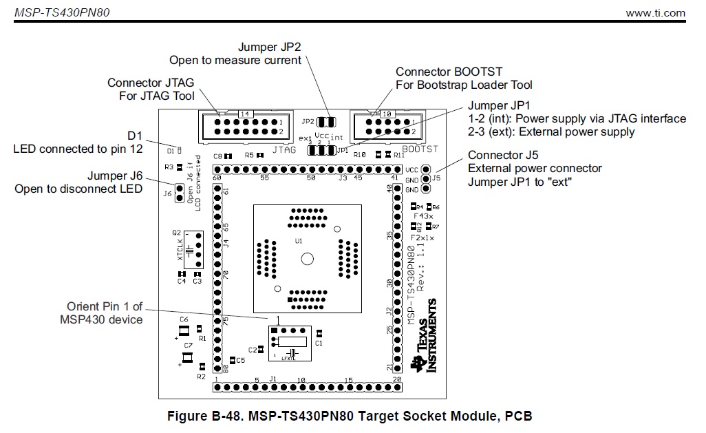

I'm at a bit of a loss, because I can't seem to find the correct PCB layout and schematic for my eval board.
I have the MSP-TS430PN80 Rev 1.0 Board. However, when I look at the latest MSP430 Hardware Tools Guide (SLAU278UV),I only see the Rev 1.1 board which is slightly different then the Rev 1.0 board.
This is the board I have:
This is the board that is in the user guide:

    I do not have easy access to the records of schematics and layouts for the previous versions of our target boards. What are your concerns with using the Rev 1.1 version? As you mentioned they are only slightly different, a revision history is maintained in the MSP-TS430PN80 hardware download package: www.ti.com/.../slac313
    Ryan
  • Thanks Ryan...the zip file was very helpful.
    I want to run the EVAL board off of external power, and per the revision history, the Rev 1.0 board used R8 and R9 to select this. The Rev 1.1 board replaced these with a jumper JP1.
    I suspected, this was what changed because I probed the board with a multi-meter. The Rev History you pointed me to, makes me more comfortable with my plan to move R8 to the R9 pads.
