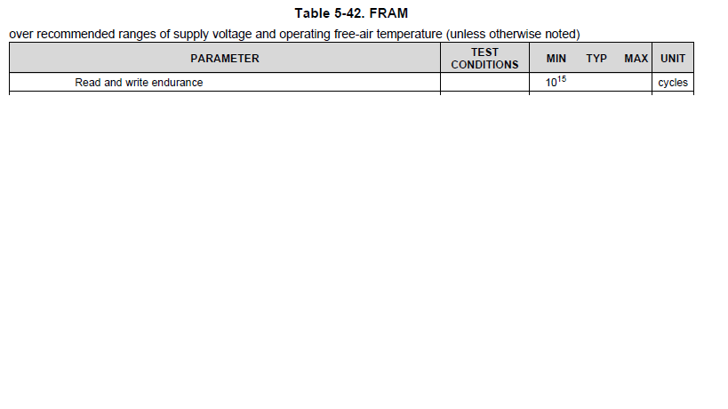

I want to check for MSP430FR series.
The data sheet of MSP430FR688x,
Read and write endurance of FRAM and are listed below.
About the items in the read and write endurance, Do you have a dependency on temperature change?

    read or write endurance of FRAM,
    Is there data of the temperature dependency?

  • The datasheet specifies the endurance as 1015 cycles minimum, over recommended ranges of supply voltage and operating free-air temperature (-40°C to 85°C).
    Are you planning to run outside that temperature range, or do you want data on how much higher the endurance might be at a specific temperature in the range?

    >Are you planning to run outside that temperature range, or do you want data on how much higher the endurance might be at a specific >temperature in the range?
    It's used in the recommendation temperature range of the chip.
    >The datasheet specifies the endurance as 1015 cycles minimum, over recommended ranges of supply voltage and operating free-air >temperature (-40°C to 85°C).
    I'm thinking with Free-Air- it isn't 85 ℃ of to 40 ℃.

    could you please specify your question in more detail? As Robert said, TI gives a read/write endurance for a specified temperature range. Do you now want to know if the endurance increases when not using the complete temperature range? Or do you just want a TI employee to confirm the specification given in the datasheet?

    I think the key issue - as mentioned in the last reply - is this:
    Unfortunately I can't quite understand what hamada is saying here. Perhaps if this is explained in more detail we (or someone from TI) can provide an answer.
