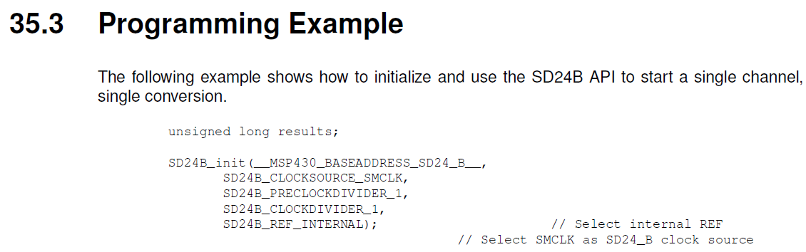

  • If so, then I would initialize it as follows:
    SD24B_init( __MSP430_BASEADDRESS_SD24_B__, SD24_B_CLOCKSOURCE_MCLK, SD24_B_PRECLOCKDIVIDER_1, SD24_B_CLOCKDIVIDER_1, SD24_B_REF_EXTERNAL );
    This is your one:
    SD24_B_init(0x0800,SD24_B_CLOCKSOURCE_MCLK | SD24_B_PRECLOCKDIVIDER_1 | SD24_B_CLOCKDIVIDER_1 | SD24_B_REF_INTERNAL));
    Do you see the difference? Not the 0x0800 - this is correct because it is defined in the header file for the processor
    #define __MSP430_BASEADDRESS_SD24_B__ 0x0800
    But you have to divide the single configuration entries by "," instead of ORing them. And there is a ")" too much at the end.
    Look at this document, page 112, chapter 35.3.
    Have fun!

  • OK, then I don't know. There were two different types of defines - the one from the .pdf has everything without the additional "_" between SD24 and B:
    And the spelling from the online resource is with additional "_":
    But since I never used those functions, I don't know. Maybe has an idea or knows someone who has?

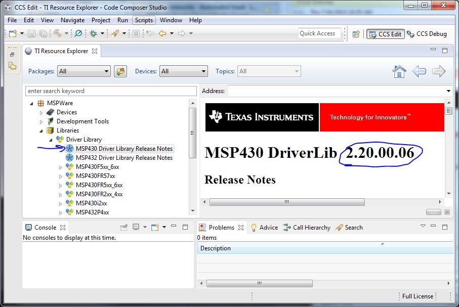

  • Hi Abhishek, Dennis,
    Can you report which version of driverlib you have installed (go to View > Resource Explorer, navigate to driverlib and you should be able to find the version number)? Base address handling got changed at one of the major revisions, and also now using initParam struct instead of passing everything as arguments. Make sure you have the latest version of MSPware, or you can try CCS cloud and cloud resource explorer, from http://dev.ti.com. Or you can update your local copy of MSPware from the CCS app center in CCS v6.

  • But which version do you use? There are changes among major versions of the libraries, which is why the function calls were looking different.
    In CCS, go to View > Resource Explorer, then in Resource Explorer go to MSPWare > Libraries > Driver Library > MSP430 Driver Library Release Notes. Should look like this:
    And if you use the example I mentioned, does it build and work?
    Katie
