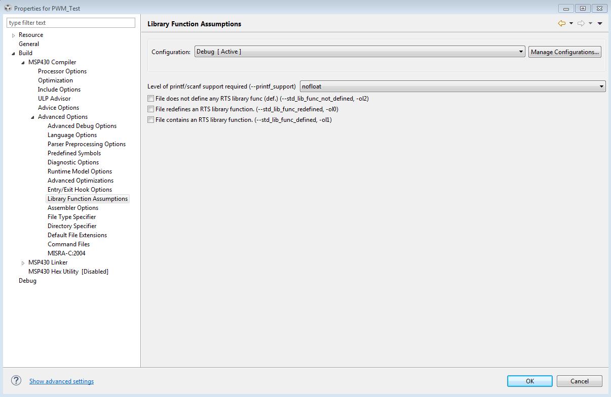

  • OK, so you're using sprintf - that makes a difference! First you have to change your sprintf-settings in CCS to support 32 bit values. It is set to "minimal" per default when starting a new project. The other two options would be "nofloat" and "full". When you do not plan to use floating point numbers, then "nofloat" is enough for you. But "minimal" cannot handle 32 bit numbers. To do this - right click on your project's name in the project explorer and select "Properties". Then go to this option and select "nofloat" on the right:
    Now your sprintf will support your 32 bit number in general, but furthermore you have to tell it that you are using a long variable, therefore add an additional "l" to the function call. Your initial
    sprintf( print_str, " FileIndex %x\n", FileIndex );

  • Thanks Dennis,
    That helped :)
    one more doubt. The "nofloat" settings is needed to use a 32bit variable with sprintf alone or it must be set if we are using a 32bit variable anywhere in the program?
  • It is only for sprintf support. If you want to use sprintf somewhere inside your program and want to pass a 32 bit value to it, you have to use at least the nofloat support variant. Full support, of course, will do everything. The use of sprintf blows up your code size - have a look before and after using it. If you enable float support it will rise again. So for smaller microcontrollers using the float support does not even work because of the large code size. That is why there are three types of implementation, causing different code size depending on the functionality you get.
