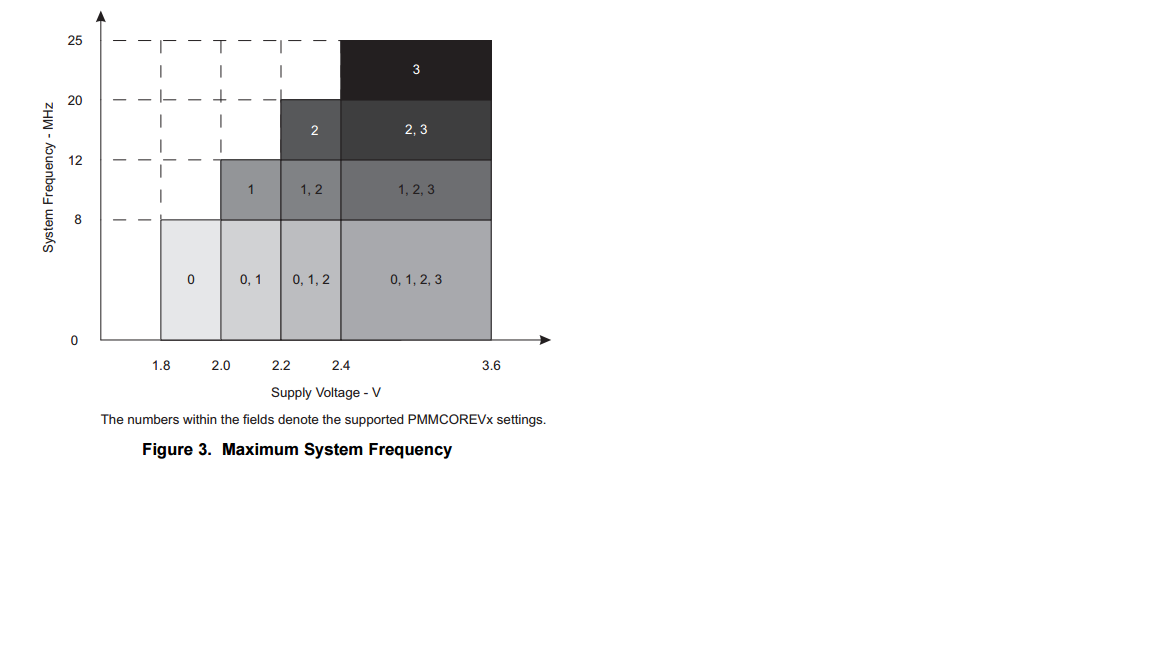

I wan to set baud rate of UART at 32MHz frequency may i know the proper configuration for it i am trying but it is giving garbage values.
selectClockSource ,clockPrescalar,firstModReg and secondModReg

Edit: The MSP430F6779 can not support a frequency of 32MHz, could you try a different frequency?
