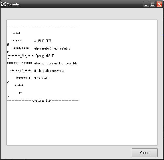

  • Hi, I have the same problem!
    I think that the problem is in the configuration of the OS of my PC but I don't know how to change it. I can tell that because I tested my EZ430-RF2500 on my PC (with windows xp UE) and on a virtual machine (windows xp colossus edition running on virtualbox) and in the latter runs OK.
    See the Splash Screen that the EZ430-RF2500 Sensor Monitor gives on my PC (with windows xp UE)
    Note how, for example, the string "Javier Silva" at the end appears. It seems that the incoming byte is "pushed" on a stack (or buffer) to form a 16bits data and "poped" like 16bits but the two bytes are twisted.
    I hope that this gives us a clue to fix the problem.

  • Twisting letters is something that can happen if somewhere in the chain the incoming data is treated as UTF16 charset and then again printed as normal ASCII.
    It may happen that the (falsely taken) 16 bit data is adjusted from network byte order to machine byte order without being sent in network byte order at all (but as a chain of single-byte chars instead).
    I must admit it is a very constructed scenario.
    Anyway, the appearance of the mangled name is even more weird.
    -J-aivreS liav jas obviously 'iv','re','S ' etc. twisted. But then, '-a' and '-J' should be twisted too. Yet the 'a' is at the right place and 'J-' is twisted and not '-J'. This is strange. The algorithm mangling the text must have coughed at the 'a'.
    Same for eTax sIsnrt where the 'I' stands as single, not switched character.
    How is the data sent to the PC? serial? USB? If USB, maybe the single, correct letters are the last byte in an USB block and therefore not twisted.
    Anyway, the console seems to be TI-made and therefore I wouldn't expect this kind of things happen, unless you have an exotic OS setup (with System-language Kanji or Chinese or such)
