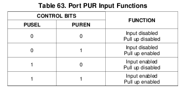

  • That bit is powered by VUSB; do you have it?
    Is PUR_EN cleared?
  • Rodney Wong said:
    No matter the state of the switch, I have been getting P4.7 = 0.
    The MSP430F5529 datasheet SLAS590L suggests that PUSEL and PUREN both need to be one to set PUR as an input and enable a pull-up on PUR:
    Therefore, my initial attempt to read the state of the "BSL" S5 switch on the MSP-EXP430F5529LP was the following:

    However, with this code the PUR_IN bit always read as one, regardless of the state of the BSL S5 switch.

  • Chester Gillon said:
    The MSP430BSL_1_00_08_00/5xx_6xx_BSL_Source/MSP430F552x_USB/BSL430_Low_Level_Init.s43 source file shows the PSEIEN bit being set and then the PUR_IN input being read
    PSEIEN is a legacy name, which doesn't appear in the MSP430F5529 datasheet or MSP430x5xx and MSP430x6xx Family User's Guide. The current name for this bit is PUIPE.
    The MSP430F5529 datasheet SLAS590L shows that PUIPE controls the input buffers for PU.0/DP and PU.1/DM, and PUSEL controls the input buffer for PURIN:
    Given that for code to read the state of PUR requires PUIPE to be set, rather than PUSEL, does this mean there is an error in the MSP430F5529 datasheet?
