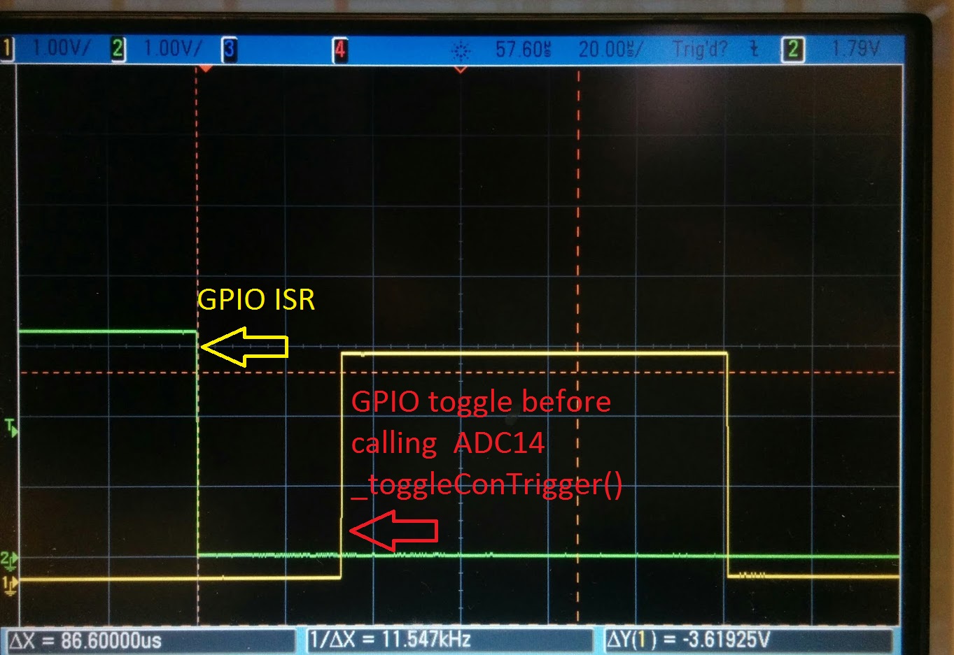

For my application, I need the MCU to trigger the ADC14 and sample as soon as it wakes up from LPM3 via GPIO ISR. I've set everything up before going to LPM3, but it seems like it will take at least 30us before anything is executed. Is there any faster way to trigger the ADC other then calling MAP_ADC14_toggleConversionTrigger(). Can I somehow tie the GPIO to trigger to the ADC trigger? Below is the relevant setup.

  • Hello Albert,
    As Table 6-27 of the device datasheet shows, an ADC conversion can be triggered by software or through a timer but not by a GPIO. There are a few microseconds lost to wake-up from LPM3 (Table 5-13 of the datasheet) and servicing the GPIO ISR, but to minimize time you can try directly writing the ADC14SC bit inside of the ADC14CTL0 register (ADC14CTL0 |= ADC14ENC | ADC14SC;) to avoid time lost due to servicing a sub function. This should be the very first thing done inside of the GPIO ISR to minimize the delay.

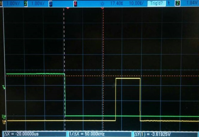

  • Thanks, Ryan. That's what I did earlier today. My code is now  simply
    void gpio_isr(void)
    P2OUT |= 0x04;
    ADC14CTL0 |= ADC14ENC + ADC14SC;
    P2OUT &= ~0x04;
    So assuming pin toggle requires ~5us, then the delay between LPM3 to first ADC sample is ~20us?
    (I'm trying to catch structural vibration, the delay ultimately determines the size of my sensor)
  • That is a fair approximation, it looks like we are down to about 10 us expected latency and 10 more us to enter into the GPIO ISR.

  • Hey Albert,
    Below is some code I ran to test the response time from LPM3 wakeup. Changing the DCO frequency to 48MHz gives a response time of 7-8us. Lower DCO frequencies cause slower response times as expected.

    (Blue is the GPIO interrupt, yellow is the ISR response)
    Martin
  • I think I got the similar result, but I think yours might be slightly faster. I will try again. In my code, I toggled a pin before and after ADC sample, and back solved for the ADC delay by subtracting the time it took to toggle. I think the totally delay from wakeup to sample was about 18us+, which is what I'm trying to minimize. (I had the ref set to VDD too)
