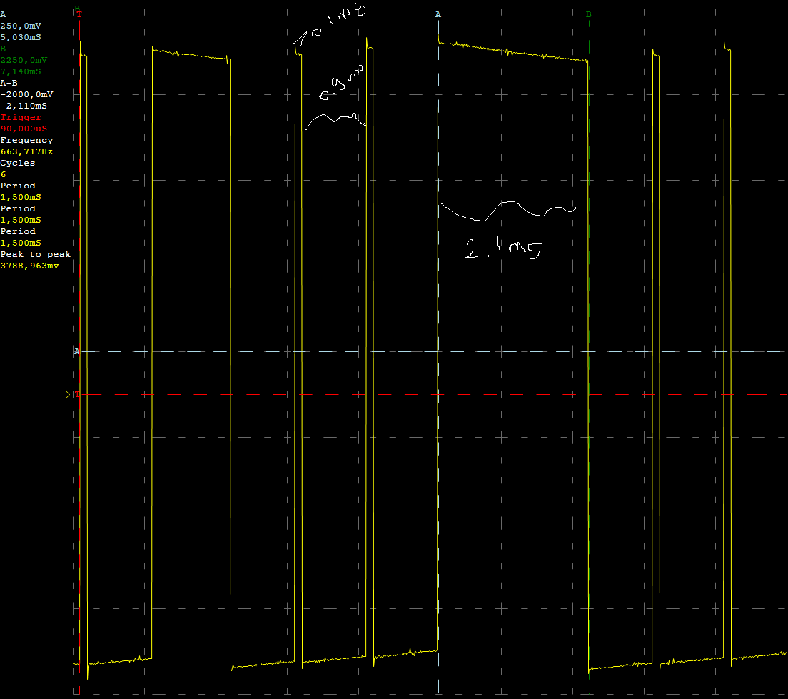

Hi Everyone ,
I look that are there any exist topic about my question but i could not find
I am working on generating pwm signal by using msp430g2553 . During wathcing the signal on oscilloscope , I released that , After the every 2 ms , The pin becomes high during 2.1ms . According to me , It should not happen .  What is the problem ?
Thank you
