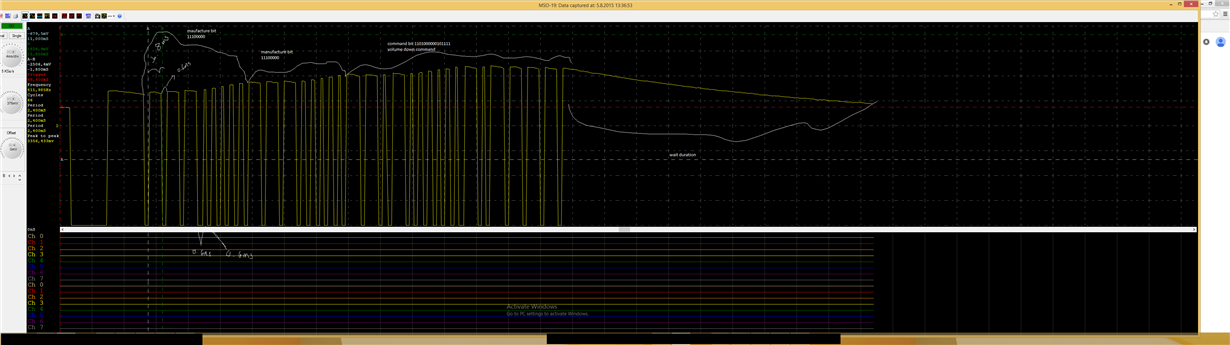

Hi everyone ,
I know that , this topic is not completely interested in here . But i wanna control samsung tv with msp430 (msp430g2553) . There are little data about how it occur.
I found something :
elektrolab.wz.cz/.../samsung_protocol.pdf //file from Samsung
usgroup.eu/.../infrared-emitter // application
lirc.sourceforge.net/.../lircd.conf.samsung //command list

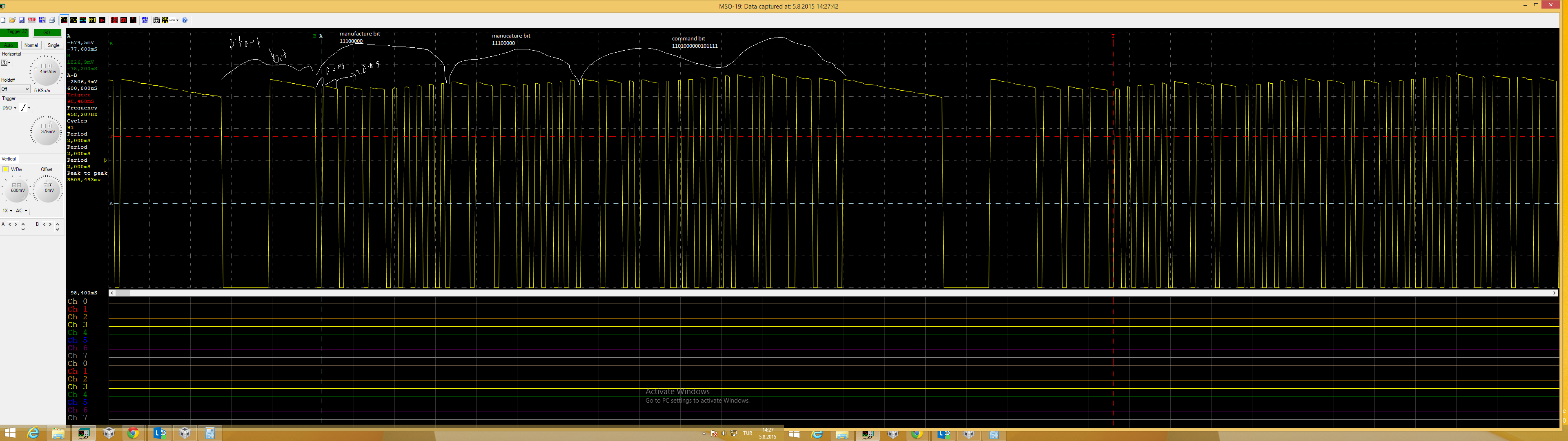

i did my system according to these source . It does not work . I think , samsung does not use this for their smart tv. Because i check it with oscilloscope ,
then result :
(channel 1)
4.1 ms high
1 ms low
1.3 ms high
0.9 ms low
1.3 ms high
0.9 ms low
1.3 ms high
0.9 ms low
0.3 ms high
0.9 ms low
0.3 ms high
0.9 ms low
0.3 ms high
0.9 ms low
1.3 ms high
0.9 ms low
0.3 ms high
0.9 ms low
1.3 ms high
0.9 ms low
0.3 ms high
0.9 ms low
1.3 ms high
0.9 ms low
0.3 ms high
0.9 ms low
1.3 ms high
0.9 ms low
ms = milisecond
as far as i know , samsung uses 39.2 kHz , one start bit , one stop bit and 32 data bit
digital zero 0.56ms high - 0.56 ms low
digital one 0.56 ms high - 1.69 ms low
start bit 4.5 ms high - 4.5 ms low
why are there these difference ?
