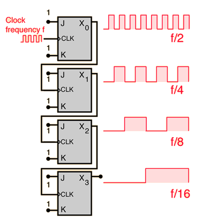

  • One more question, does TimerA run independently of CPU, meaning CPU can do other stuff while the timer is counting?
  • The TAxR registers are sourced from the clock source you specified for them. But they are connected in hardware. With setting the individual bits you simply route the selected clock source to the timer module and by the divider bits, for example, you route the clock signal through some flip-flops (or grab the signal from another flipflop, I don't know the internal construction), but it is all done in hardware.
    Example for a clock-divider:
    (Just a pic from the net - f/16 is not a divider from the timer A module)
    So in short: The timer is sourced without interaction of the CPU. The timer can ping the CPU in form of an interrupt to react on a special event. The CPU can even be in low power mode and the timer is still running, waking the CPU up to do something.
    Dennis
  • Okay, thanks. So in theory, it would be possible to generate pulses with MSP and have a frequency counter to measure frequency of said pulses without interfering with pulse generation too much?
  • I don't know your pulses and the amount of CPU processing they require, but the timer could, for example, generate output pulses like a PWM or a square wave without any CPU interaction. For a frequency counter, the timer also runs without the CPU, collecting the incoming pulses, but for processing the result when the timer generates an interrupt, the CPU must jump in, of course.
