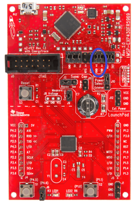

The MSP430FR5969's GUI is not coonecting to the code for taking temperature reading continuously over a period of time. Someone please help.

Have you double checked if you downloaded the right firmware onto the target board? And did you try if it works when just plugging the board into the USB without having any IDE running in parallel? Are there any Rx/Tx jumpers on the board that are accidently not set ptoperly?
Maybe you go through the LaunchPad User's Guide for your board. It contains useful information.
These are the jumpers I am talking about:
I've checked the User's Guide but it does not solve my problem :/
Also, the max Voltage the MSP430FR5969 controller can take is 5V or 3.6V?
