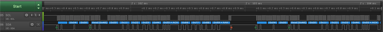

I tried set up an eusci module in i2c mode but with no luck.
The driverlib examples and the ones for the device do not work. I hooked up an logic analyzer on the pins but they stay high all the time.
Have any of you got it up and running ?

    I connected an Atmel transceiver to the MSP432 launchpad. The transceiver module has an I2C EEPROM module to store the EUI64 address and already has the SDA and SCL line pulled up using 10k resistors.
    I've tried using eusci0 and eusci1. The same problem. I don't even see the start condition on the logic analyzer, the signals remain high.

    First I used directly the registers, doing the configuration myself. Next I tried using the driverlib examples.
    Both cases rise up the same issue: the code get stuck waiting for the UCTXIFG flag after sending the start condition by setting the UCTR and the UCTXSTT bits in the UCxCTLW0 register.
    I checked the UCTXSTT bit, which by the reference manual, should be cleared after successfully sending of the start condition.
    Using a logic analyzer, I can confirm that the start condition is never sent.
    Andrei

  • Hi Sean,
    It looks like the code you provided works, I can see a start condition and some data being sent.
    What was the driverlib issue ?
    I will browse my code to see what am I doing wrong.
    Andrei
  • Hi Andrei,
    Glad to know that the code is working, I've contacted someone from the MSP432 driverlib team to further look into the example code.
    Sincerely,
    Sean
  • Hello Andrei,
    Could you tell me the following information?
    • Which version of MSP432 DriverLib are you using? There should be a version stamp on top of the DriverLib examples or header/source files with this information.
    • Which IDE are you using (CCS/Keil/IAR/etc.)
    • Which version of MSP432 are you using? On the actual chip, under the part number, there should be a RevA or RevB on the chip.
    I have tested the stock i2c_master_rw_repeated_start-master_code and i2c_master_rw_repeated_start-slave_code code examples using Code Composer Studio 6.1.0  and cannot recreate your problem. Hooking up a logic analyzer to the line, I get the following signals:
    ... which is the expected output from the code examples. I am using the latest MSP432 DriverLib (2_20_00_08) on the web at:
    Thanks for bringing this up though as if there is an issue we definitely do want to resolve it.
    Tim
  • Hi Tim,
    I managed to find what the problem was. For some reason, I was not configuring the GPIO pins properly. Everything works now.
    In my project, I'm not using driverlib at all. The configuration is done by writing directly to the registers.
    Thanks for your help.
    Andrei
