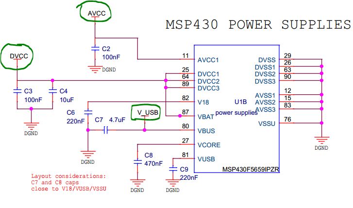

MSP430F56xx usb design, power source
Other Parts Discussed in Thread: MSP430F5659, MSP-EXP430F5529LP
I'm designing a micro usb port on the MSP430F5659. I'm a little bit confused about the Vbus power source.
based on the application report "Starting a USB Design Using MSP430™ MCUs"  there is a Schottky diode placed on the Vbus.
in page 17 I noted  "The diode on VBUS is placed there to ensure compliance with the USB 2.0 specification's requirement
that the device never source current toward the host over VBUS"
however, this diode doesn't exist in the MSP-EXP430F5529LP_Schematic. so the MSP430 could be powered from the VBUS ?
 could you please explain me if I need it form my design or not ?
