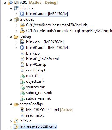

    I can find it under ccs_base/msp430/include now
    But I also notice that there is another cmd file called lnk_msp430f5529.cmd in the project
    What is the difference between these two cmd files?
    Eric
  • That's a completely different file mate.
    The lnk_msp430f5529.cmd contains information for the linker (where to put different code segments, memory ranges and stuff like that).
    Double click it to open it and see what it contains. Then you'll see the differences between the two files.
