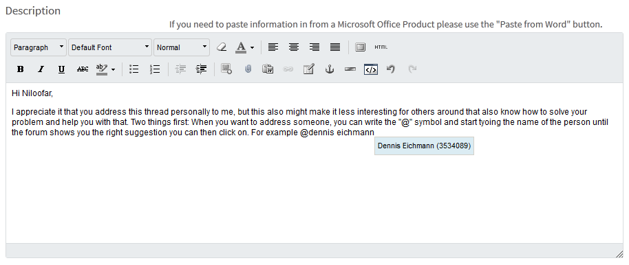

  • Hi Niloofar,
    I appreciate it that you address this thread personally to me, but this also might make it less interesting for others around that also know how to solve your problem and help you with that. Two things first: When you want to address someone, you can write the "@" symbol and start typing the name of the person until the forum shows you the right suggestion you can then click on. For example @dennis eichmann would look like this:
    Then when inserting code, please don't throw all your lines into the window since it is very hard to read. Instead, use the rich formatting which can be found on the lower right when pressing on reply, then use the code insertion tool:
    Your code then gets line numbers and is better layoutet.
