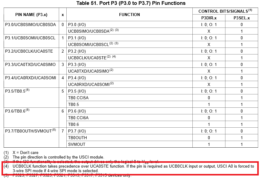

I am learning MSP4305529, and I am confused about the function select about GPIO.
For example, P3.2 has three peripheral module functions,
Q1: If I select  P3SEL | = BIT2, which peripheral module function is selected?
Q2: I guess clock signal input/output is determined by BIT3 of P3DIR (please correct me if I'm wrong), but under what circumstance is the slave transmit enable selected?
