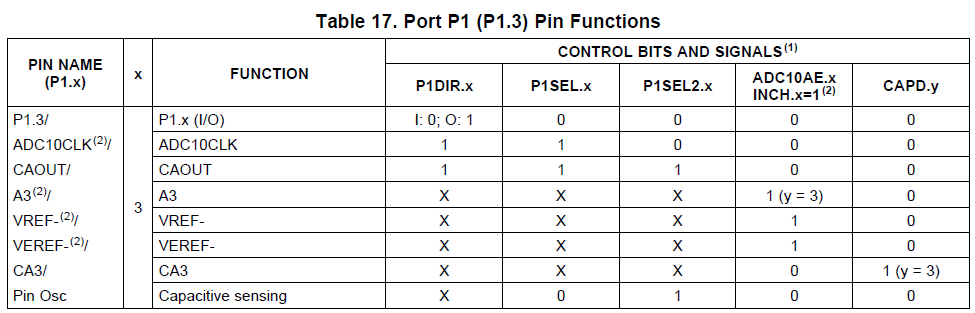

I use Grace as a "manual" for MSP430G2xxx programming: Click a setup, and look at the registers. I do not use grace in the code written. Now I find that Grace gives output CAOUT options on the comparator including pins 1.1, 1.7 and 3.7. I can not find the register settings for this configuration. This is for an MSP430G2553 in particular.

    Look at the datasheet starting at page 43, table 16 and following - it shows the connections between internal modules and the pins and the appropriate bits you have to set for each function. For example P1.3 and CAOUT (page 45, table 17):
    You will have to set 0x08 in P1DIR, in P1SEL and in P1SEL2. ADC10AE has to be cleared for that pin, same for CAPD.
