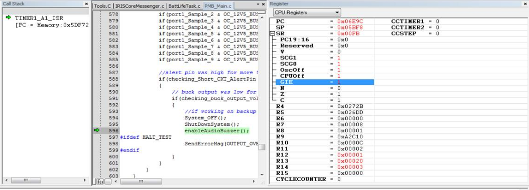

1.After Switch Press, Main while(1) is not getting executed, but interrupts are getting served. SYSNMI interrupt are getting triggered infinitely. Also observed that  when SYSNMI is triggered 'VMAIFG' Flag is set.
2.Other behavior is after switch press,if i try to keep break points getting a warning:CPU is OFF and Further debugging is not possible then i  checked CPU Register status CPU OFF,OSC OFF,SCG0,SCG1 bits are set.

    The two behaviors you note (main code not executing and CPUOFF = OSCOFF = SCG0 = SCG1 = 1) indicate that the device has entered a low power mode. This explains why the CPU is off, debugging is not possible, and the while(1) is not being serviced while interrupts are. Do you ever intentionally enter a low power mode (LPM) with global interrupts enabled (GIE)? Can you locate the point at which the CPU register status bits are set? Finding this in your code will help solve the issue.

    Before switch press if i check the status register ,LPM bits are not set.After switch press only LPM bits are set.

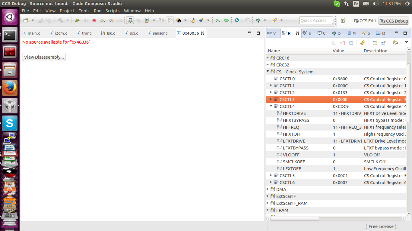

  • Check the IFG flags in the register window of your debugger to determine the interrupt source. Are you saying that the OFIFG is set even though you have not initialized or used the LFXT in your program? Do you have an external crystal connected to the XT pins? Is OFIFG not set before the sensor data request and set afterwards? Do any of the sensors use a peripheral that is sourced by a clock sourced by the LFXT? Is there any possibility of ISR overlap, for example between the DMA/I2C and the sensor peripherals?

    -- Yes I have observed that in CCTL4 Register I Saw that LFXT value remains 1 though, If I try to make it 0.
    -- I have not used LFXT as source in my code anywhere.
    -- LFXT flag was not set when the 1ms i2c read is going on ( as individual It's running fine)
    -- But when Request for data (1ms I2C read will also be On at that time ) first 2-3( random) times it comes perfect.
    -- When not come, I pause the program in ccs and its says the at location 0xFFFA.
     if you need the code to check, I can mail or share you the code so that you can share light on it. I have also attached the screen-shot of my problem.
    I have got one more screen shot of what you have said. Please find it below.
    Thanks.,

  •  Hi Ryan Brown1 (3460875) ,
    I have done the check and attaching the snap shot.

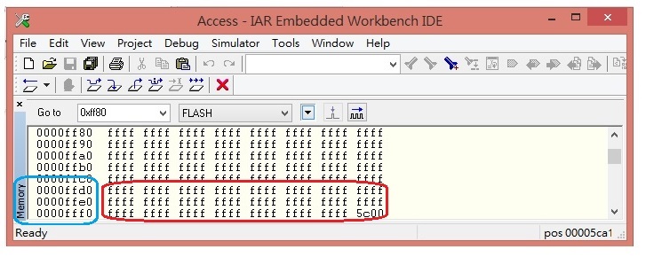

    What is the content of the address 0xFFFA? Please show us all the contents of addresses from 0xFFD0 to 0xFFFF.
    I do not think your problem is caused by a UNMI. Because that would cause the PC to be loaded with the content of 0xFFFA which is probably not in "the area of 0xFFFA".

    3.) the contents of address from 0xFFD0 to 0xFFFF Are as below.

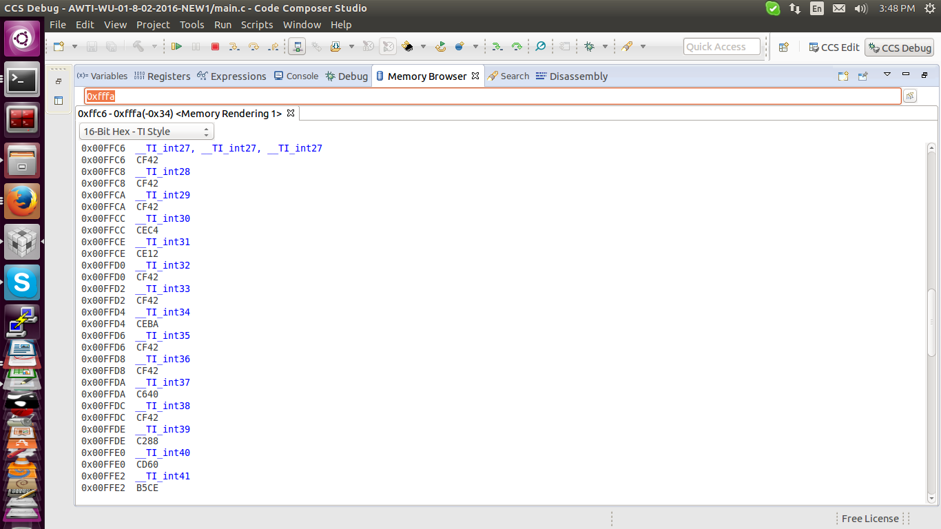

  • What you have shown is the Map. I meant something like this:
  • ok., I am using CCS. do you know how I can show you this in CCS?
    If yes, Than I can directly check.
    And If I am not mistaken You are asking something like below?
  • Okay.
    It looks like all the unused interrupts share the same trap at location 0xCF42 which is probably a do nothing infinity loop. If the Program Counter ended there, you really cannot tell which one of the unused interrupt caused it. I cannot rule our UNMI, but there is no evidence that it is the cause of the problem. It is possible that the problem is not related to interrupt at all.
