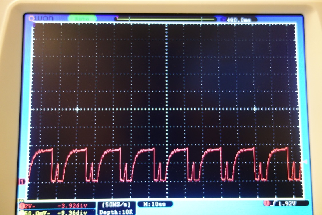

  •  Mohammed,
    After seeing the screen capture of SDA Line, the shark fin pattern indicates that your pull up resistors are too large. Try 3.5 kOhm and let me know what that does. you may need to go even lower.
  • I tried going lower. I tried 4K7, 3K3, and 1K and got the same bytes all the byte. On the Oscope, The SDA signal looked like the clock one when I used the 3K5 and 1K resistors.

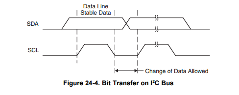

    Can you get a screen capture of both your data and your clock on the same screen in the same time domain, and at an amplitude that will match the wave heights?
    We are looking for a signal that looks like this:
    I noticed you have some spikes in your clock signal (I'm assuming these are not the signal themselves) that could be contributing to the issue. Do you know what is causing these? It's likely another communication line crossing your i2c line, this could be from the UART which we could test with a delay. If these spikes are your SCL signal, then this is a big problem, since i2c SCL should be a 50% duty cycle. Maybe send me a picture of your setup?

  • Cameron,
    For some reason I can't zoom into the clock signal on the oscilloscope. It always looks like spikes. I even tried commanding the sensor with Arduino. I was able to read from the sensor over I2C and send the data back over UART without any problem. However, I still get the spikes for the clock line on the oscilloscope although the system was working fine. It seems that the oscilloscope/probe circuit is interfering somehow with my circuit. I also tried on the MSP432 launchpad without using UART.
    I also reset the value in the CSCTL1 register, and tried different values, but I had the same issue. Please let me know how a logic analyzer could help in this case. I will send you a picture of my setup shortly.
