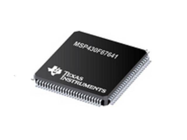

  • Let me explain what I was asking.
    MSP430F67461 is an I/C. Without any external hardware, it looks like this.
    You said you are using JTAG to debug it already. To me, that means you already have some external hardware that let you connect the MSP430F67461 to a PC to do so.
    If so, it is possible that you may be able to do BSL without any additional hardware. But I need to know exactly what you already have.

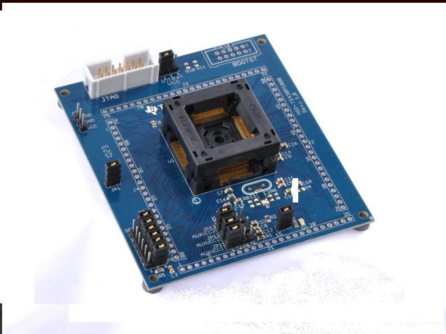

    Do you have something like this to hold the MSP430F67461 and making connections?
    Do you have something like this to connect to your PC?
    Exactly, what do you already have?
